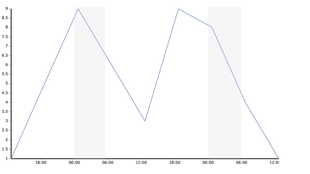

Thanks, but that doesn't stay in the right place when the chart allows panning.
Also, how do you draw more than one rectangle?
I have attached a sample image of what im after (basically indicating nighttime on the chart)

Pep
Posts: 3316
Re: Draw Rectangle based on DateTime
Post by Pep » Fri Mar 03, 2017 10:13 am
I did a mistake passing the left parameter in the draw rectangle method. The following code works fine even if you pan over the Chart. You can also draw several rectangles (areas).
        private void Chart_BeforeDrawSeries(object sender, Steema.TeeChart.Drawing.Graphics3D g)
            var tmpHour = Utils.GetDateTimeStep(DateTimeSteps.OneHour);
            Rectangle rect = Chart.Chart.ChartRect;
            g.BackColor = Color.Red;
            g.Rectangle(Chart.Axes.Bottom.CalcXPosValue(DateTime.Now.ToOADate() + tmpHour * 1), rect.Top + 60, Chart.Axes.Bottom.CalcXPosValue(DateTime.Now.ToOADate() + tmpHour * 3), rect.Bottom - 60);
            g.BackColor = Color.Yellow;
            g.Rectangle(Chart.Axes.Bottom.CalcXPosValue(DateTime.Now.ToOADate() + tmpHour * 4), rect.Top + 60, Chart.Axes.Bottom.CalcXPosValue(DateTime.Now.ToOADate() + tmpHour * 5), rect.Bottom - 60);

Post by theyield » Mon Mar 06, 2017 4:50 am
Thanks, that works : )
