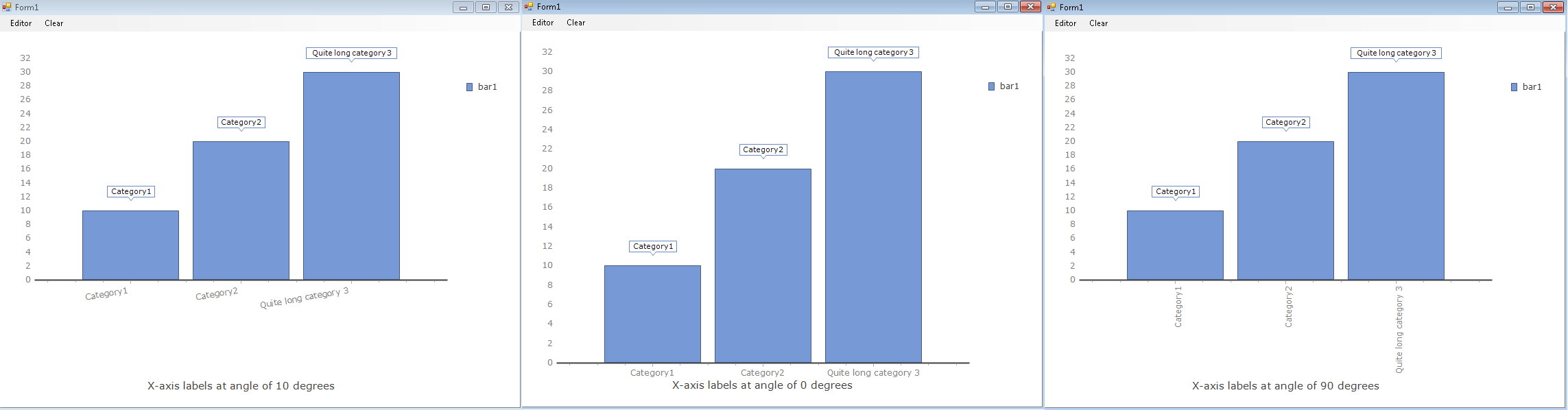

When creating a chart where the bottom axis labels are rotated between 1 and 89 degrees, the chart area is only as high as it would be when the labels are rotated 90 degrees.
This means that there can be quite some unnecessary whitespace between the bottom axis title and the bottom axis labels.
I have added some screenshots of the behavior and a code snippet below to reproduce the behavior.
Is this behavior considered a bug, and are there some easy work-arounds to automatically avoid the unnecessary whitespace?

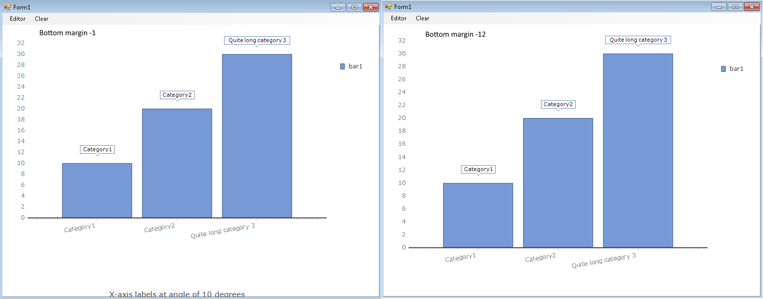

Unfortunately, the suggested work-around by adjusting the bottom margin causes the bottom axis title to be cut (as can be seen in the screenshots below), so this work-around cannot be used.
bottom margin reduced - axis title cut

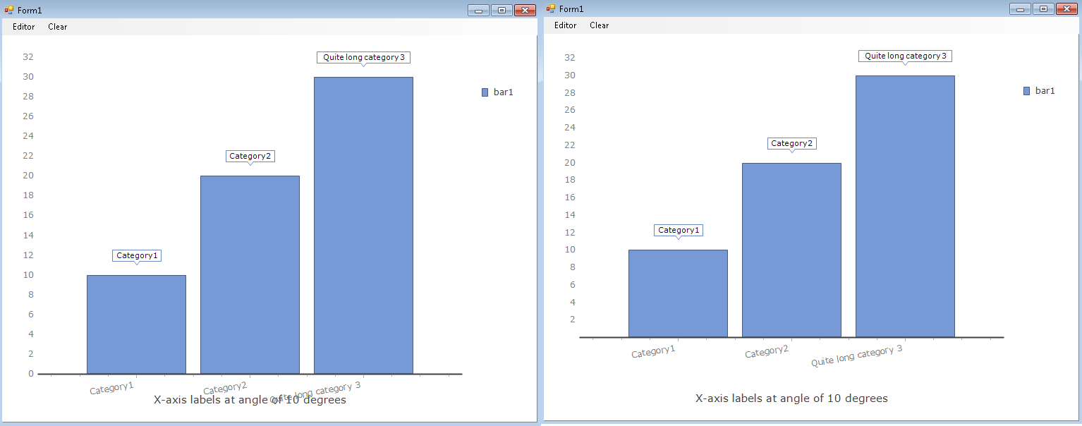

In researching possible solutions a bit further, I stumbled upon the AxisLabels:CustomSize property, which I can use in code to influence the space that is taken by the bottom axis labels:
tChart1.Chart.Axes.Bottom.Labels.CustomSize = 20;
With this property, it seems that I can avoid the unnecessary whitespace if the custom size is chosen well (see screenshots below).
To correctly indicate this custom size, it seems however that I need to know the height of the largest rotated axis label.
Do you have any idea whether and how it is possible to calculate this?

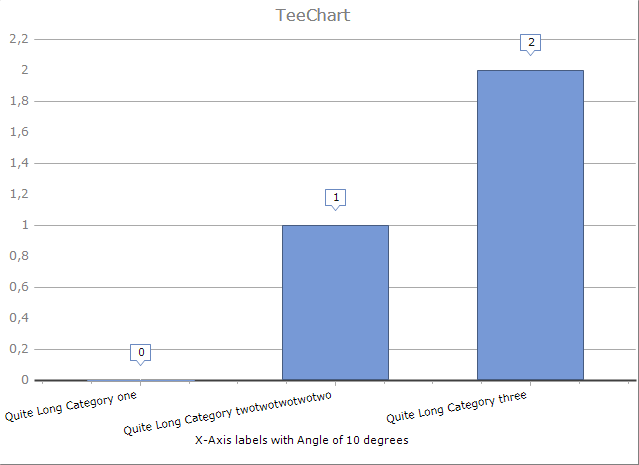

I think custom labels can handle this better - the following code:
    Bar series;
      series = new Bar(tChart1.Chart);
      for (int i = 0; i < 3; i++)
        series.Add(i); //, "Quite Long Category " + i.ToString());
        tChart1.Axes.Bottom.Labels.Items.Add(i, "Quite Long Category " + i.ToString());
      int degrees = 10;
      tChart1.Axes.Bottom.Labels.Angle = degrees;
      tChart1.Axes.Bottom.Title.Text = $"X-Axis labels with Angle of {degrees} degrees";
produces the following chart for me here:

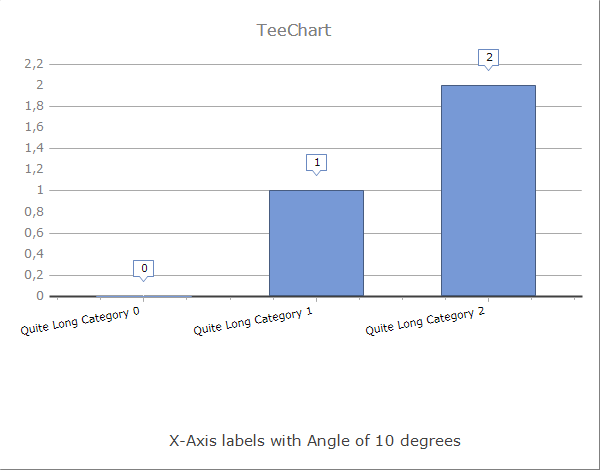

I'm afraid though, it doesn't help with the issue I'm facing. As you can see in your own screenshot, there is still a large blank area between the axis labels and the axis title, even when using custom labels.
Possibly it is easier to calculate the height of the labels when using custom labels, so I can use it in combination with the CustomSize property?

which gives me:
I will look into the possibility of incorporating this technique (or similar) to ensure precise axis title positioning with rotated labels.
