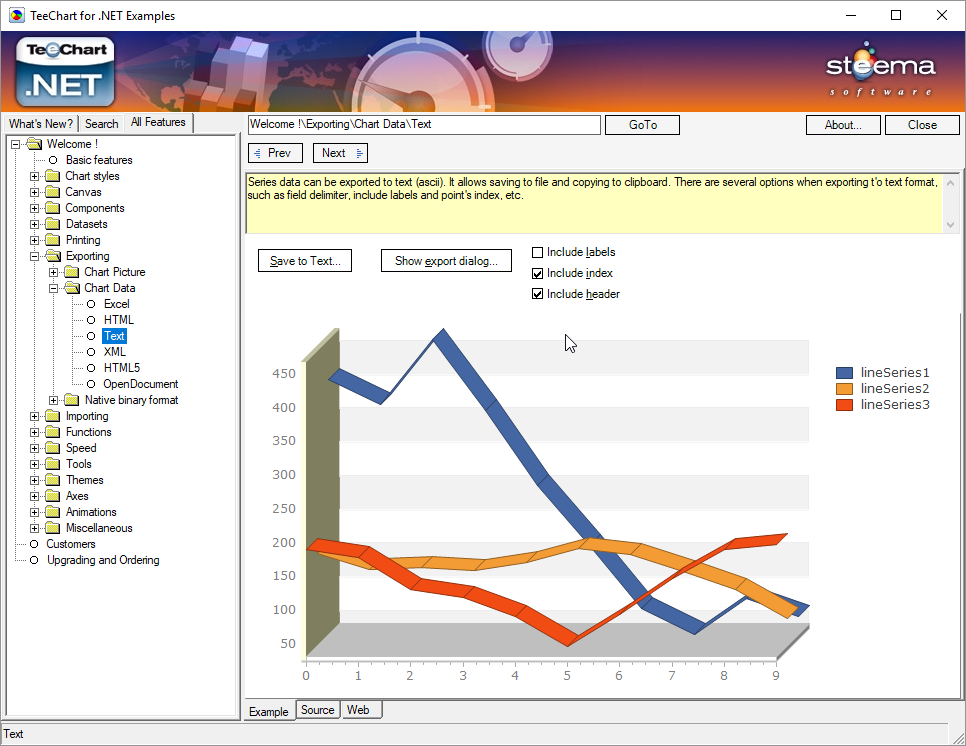

Thank you for the Word document describing your issue. Would you please be so kind as to give us the data to used to generate this chart? You can easily export the data to a text file, for example, as can be seen in the Feature Demo shipped with TeeChart:
