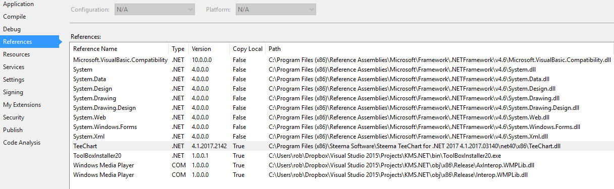

Have downloaded and installed TeeChart .NET Version 4.1.2017.2142. Install ran fine - no problem. I removed the reference to the older version and added the latest TeeChart.dll to the .NET references for my application (screen shot attached).

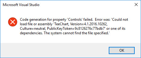

When I build and run my application I get the error that code generation could not load the old TeeChart.dll or one of its dependencies (screen shot attached).
Is there something else I have to change to update Visual Studio 2015 and my application to use the Version 4.1.2017.2142?
Rob

Re: Problem with plotting bar graph
Success!
I uninstalled and reinstalled the latest .NET version of TeeChart and all is working fine now.
