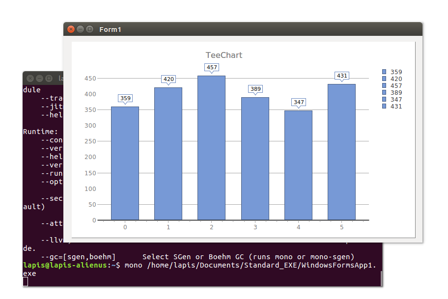

by a stroke of serendipity, there is now a TeeChart binary that will work seamlessly on mono:
Screenshot from 2017-11-16 12-54-21.png (44.12 KiB) Viewed 8849 times
you can download this binary and test it yourself using Nuget:
https://www.nuget.org/packages/Steema.T ... T.Standard
a watermark will appear on the Chart, but if you have a valid TeeChart license then sales@steema.com will be happy to give you a license for it.

I'd installed the NuGet package and I can compile in Visual Studio and run it under mono.
Thanks and best regards
