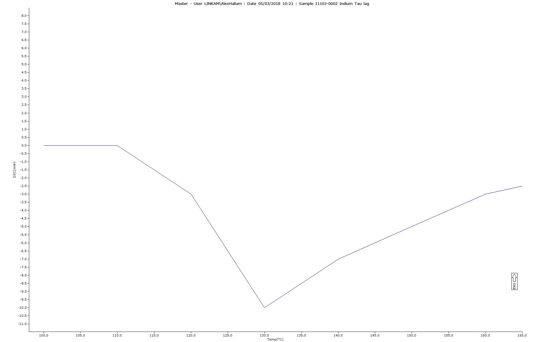

However if I change my axis limits to 128 to 165, the chart cuts off alot of data.
I noticed that this has something to do with the X value of the last point in the series and that this behaviour can be overridden by setting the Fastline->calcVisiblePoints boolean to *false*. However this is a protected field so I cant do this programmatically.
Am I doing something incorrect here?
Data missing when limits are 128 to 165
Axis 128 to 165.jpg (71.99 KiB) Viewed 9952 times

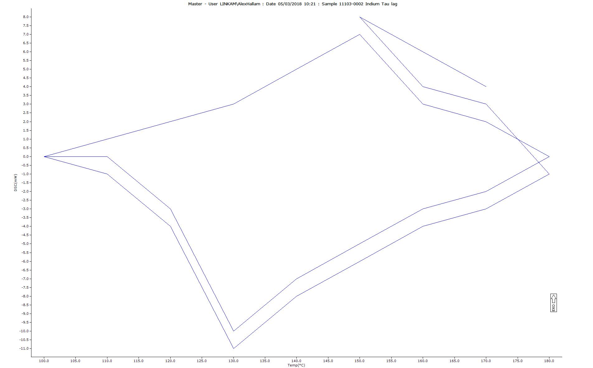

All data visible when x axes limits are 128 to 182
Axis 128 to 182.jpg (102.1 KiB) Viewed 9949 times

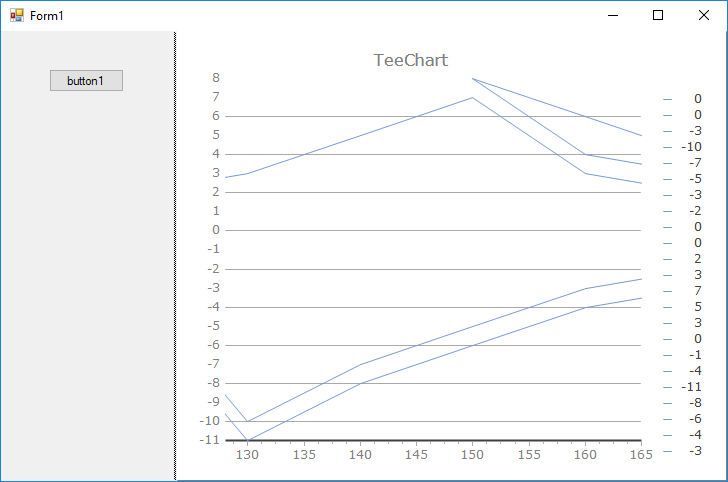

which gives me:
