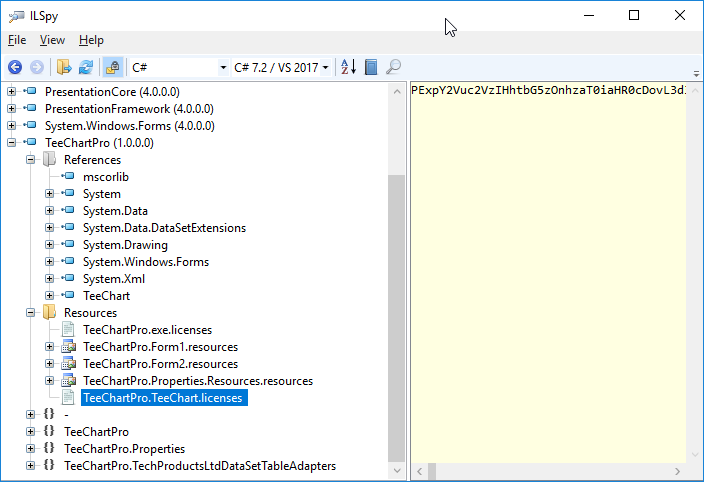

it is possible to add TeeChart.licenses to a Windows Form project as an Embedded Resource making an additional TeeChart.licenses file unnecessary, as this test project shows:
The question is: why does this not work in your case? In order to understand why it doesn't work in your case I will need to be able to reproduce this issue here - could you please send me a Windows Forms project in which using TeeChart.licenses as an Embedded Resource does not work? Or maybe you could give me a detailed description of how to reproduce your problem here?

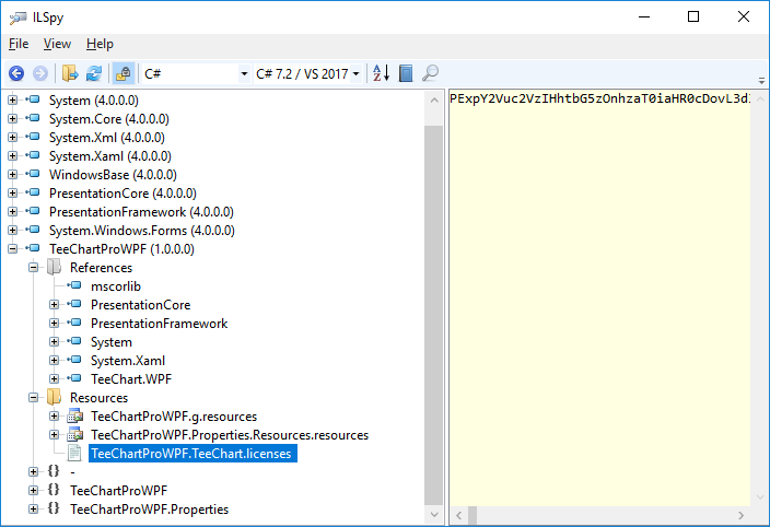

we have a WPF Solution, not a WinForms Solution. Does this make a difference?
Re: New Licensing
Post by Christopher » Tue Nov 27, 2018 11:36 am
HCCKPM wrote:
Tue Nov 27, 2018 11:01 am
As with Windows Forms, TeeChart.licenses files can also be added as 'Embedded Resource' to WPF projects:
