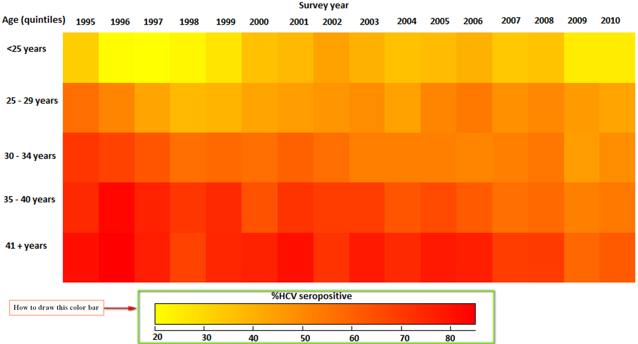

Hi Steema Support,
We have one query regarding heat maps. How we can draw these plot.
I am attaching a demo image for your reference.
I am using teechart 2012.
Which plot we use to draw these kinds of maps? And also how we can draw this color bar?

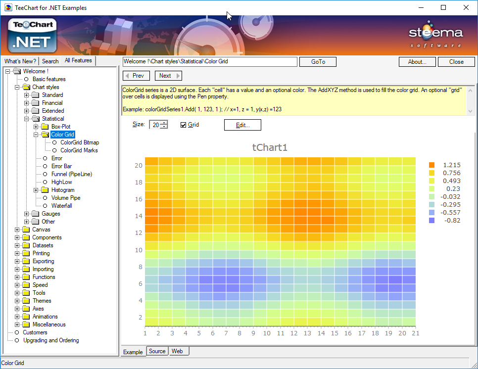

Re: Heat maps
Post by Christopher » Wed Dec 05, 2018 7:30 am
you can use the ColorGrid, e.g.
