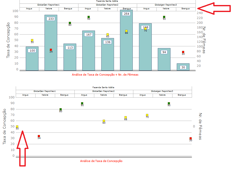

I am building a chart that has 2 series (1 bar and 1 point) and multilevels and can not find a way to fix 2 issues:
1 - as you can see clearly at first chart, the header is bumping with the chart area. I would like to reduce the chart area to avoid it.
2 - at 2nd chart I would like to centralize the points withing each header

This is the code where I configure the series:
Dim myBar As Steema.TeeChart.Styles.Bar = New Styles.Bar(myChart.Chart)
Dim myPoint As Steema.TeeChart.Styles.Points = New Styles.Points(myChart.Chart)
myBar.Clear()
myPoint.Clear()
For i = 0 To lsInd.Count - 1
If nNrInfo = 2 Then
myBar.Add(Convert.ToDouble(lsInd(i)(1)), v_corSubTitForm)
End If
myPoint.Add(lsInd(i)(0), If(lsInd(i)(0) < 35, Color.Red, If(lsInd(i)(0) > 75, Color.Green, Color.Yellow)))
Next
myBar.MultiBar = MultiBars.None
myBar.Legend.Visible = False
myBar.HorizAxis = HorizontalAxis.Bottom
myBar.VertAxis = VerticalAxis.Right
myBar.Marks.Visible = True
myBar.MarksOnBar = True
myBar.Marks.TailStyle = MarksTail.None
myBar.Chart.Axes.Right.Title.Text = "Nr. de Fêmeas"
myBar.Chart.Axes.Right.Automatic = True
myBar.Chart.Axes.Bottom.Labels.Visible = False
myBar.Chart.Axes.Right.Grid.Color = Color.Transparent
myBar.SideMargins = True
myPoint.HorizAxis = HorizontalAxis.Bottom
myPoint.Legend.Visible = False
myPoint.VertAxis = VerticalAxis.Left
myPoint.Marks.Visible = True
myPoint.Marks.Font.Size = 16
myPoint.Marks.Transparent = True
myPoint.Marks.ArrowLength = -myPoint.Marks.Font.Size
myPoint.Marks.Arrow.Visible = False
myPoint.Marks.ShapeStyle = Drawing.TextShapeStyle.RoundRectangle
myPoint.ColorEach = False
myPoint.Marks.Color = Color.Transparent
myPoint.Marks.TailStyle = MarksTail.WithPointer
myPoint.Marks.Font.Size = 7
myPoint.Chart.Axes.Left.Title.Text = "Taxa de Concepção"
myPoint.Chart.Axes.Left.Automatic = False
myPoint.Chart.Axes.Left.Minimum = 0
myPoint.Chart.Axes.Left.Maximum = 100
myPoint.Chart.Axes.Left.Increment = 10
myPoint.Chart.Axes.Bottom.Labels.Visible = False
And this is the "Afterdraw" procedure (to draw the header) (this procedure is from Steema Example):
If (myChart.Series.Count > 0) Then
g.Pen.Color = Color.DarkGray
Dim vertgrid As New List(Of Integer)
vertgrid.AddRange(ggfGetSecoesVerticais())
Dim topRowCount As Integer = ggfGetSecoesHorizontais() + 1
Dim hasMeses As Boolean = (vertgrid(0) > 2)
Dim hasCats As Boolean = (vertgrid(1) > 2)
Dim hasDivs As Boolean = (vertgrid(2) > 2)
Dim catCount As Integer = vertgrid(0) * vertgrid(1)
Dim divCount As Integer = vertgrid(0) * vertgrid(1) * vertgrid(2)
'Dim chartTop As Integer = myChart.Axes.Left.IStartPos + 8 ' //some separation
Dim chartTop As Integer = myChart.Axes.Left.IStartPos + 5 ' //some separation
myChart.Axes.Left.IStartPos = chartTop + 80
'myChart.Chart.Axes.Right.IStartPos = myChart.Chart.Axes.Right.IStartPos + 80
Dim chartLeft As Integer = myChart.Axes.Left.Position '+ 15
Dim chartBottom As Integer = myChart.Axes.Bottom.Position
Dim chartRight As Integer = 0
'Top Grid Zone
If (myChart.Axes.Custom.Count = 0) Then
chartRight = myChart.Axes.Bottom.IEndPos
Else
chartRight = lastHorizAxis.IEndPos
End If
For i As Integer = 0 To topRowCount - 1
g.Line(chartLeft, chartTop - (15 * i), chartRight, chartTop - (15 * i))
If (hasDivs And (i = 0)) Then
'ggpImpTopGrid(g, chartTop, chartLeft, chartRight, chartTop - (15 * i), 15, 2, divCount, "div", vertgrid(2))
ggpImpTopGrid(g, chartTop, chartLeft, chartRight, chartTop - (15 * i), 15, 2, divCount, lsN3_2, vertgrid(2))
End If
If ((hasDivs = False And hasCats And (i = 0)) Or (hasDivs And hasCats And (i = 1))) Then
'ggpImpTopGrid(g, chartTop, chartLeft, chartRight, chartTop - (15 * i), 15, 2, catCount, "cat", vertgrid(1))
ggpImpTopGrid(g, chartTop, chartLeft, chartRight, chartTop - (15 * i), 15, 2, catCount, lsN2_2, vertgrid(1))
End If
If ((hasDivs = False And hasCats = False And (i = 0)) Or (hasDivs And hasCats = False And (i = 1)) Or (hasDivs = False And hasCats And (i = 1)) Or (hasDivs And hasCats And hasDivs And (i = 2))) Then
'ggpImpTopGrid(g, chartTop, chartLeft, chartRight, chartTop - (15 * i), 15, 2, vertgrid(0), "month", vertgrid(0))
ggpImpTopGrid(g, chartTop, chartLeft, chartRight, chartTop - (15 * i), 15, 2, vertgrid(0), lsN1, vertgrid(0))
End If
Next

Re: MultiSeries and MultiLevel Chart
Post by Christopher » Thu Jan 24, 2019 7:59 am
Hello!
I'm afraid I can't run your code as there are method definitions that are missing (e.g. ggfGetSecoesVerticais()) - could you please try to produce a Minimal, Complete, and Verifiable example (as defined here) with which I can reproduce your issue here?
I also note that you have not provided code for the second of your two issues.
We are very willing to help, and in our experience it is always more easier to do so when we can reliably reproduce our clients problems here on our machines!
