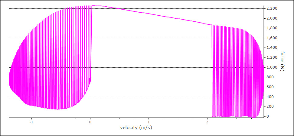

Thanks for your reply. I cannot figure out why there is a difference. With follow code:
For count = 0 To plotsamples
FastLineForce.Add(velocity(count + zoomstart), force(count + zoomstart))
Next count
I get the distorted graph attached. Some points are plotting correctly but then there is a sequence out and the back to correct etc.

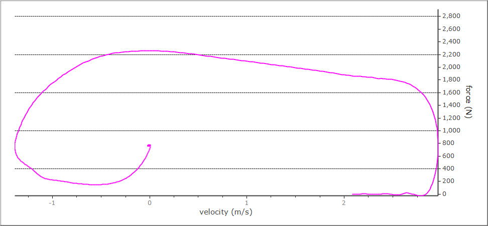

However, if I use the following code with the exact same data arrays:
xdata(count) = velocity(count + zoomstart)
ydata(count) = force(count + zoomstart)
Next count
FastLineForce.Add(xdata, ydata)
The graph is displayed correctly (image attached). I have attached the data as CSV but the Forum would not allow upload with .CSV extension so I have renamed FastLine Data.zip to get around the filetype filter.

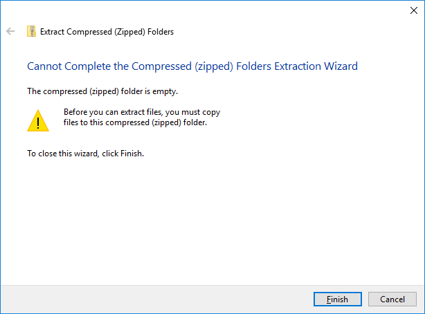

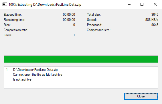

I'm having problems trying to open the zip file here - both 7-Zip and Window's built-in zip extractor give me errors:
could you please generate a new zip file for me and post it here again?

The file is CSV so no need to unzip. Just rename changing .zip to .csv
I had to do this because the forum will not accept files with .csv extension.

that'll teach me to read things more carefully! Thanks for your patience in sending me what I had mistakenly expected.
The answer is the ordering of the XValues - by default they are ordered, so when you add your values in one-by-one they are ordered. Adding in the values directly to the arrays bypasses this. The solution is to set the XValues ordering to None, e.g.
