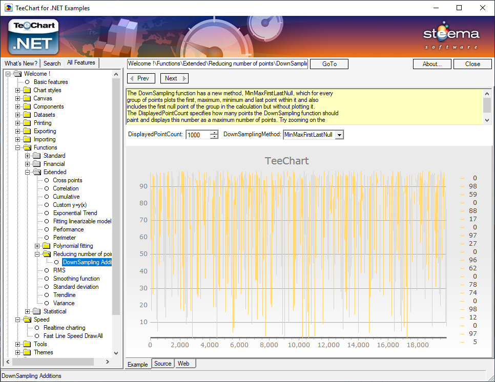

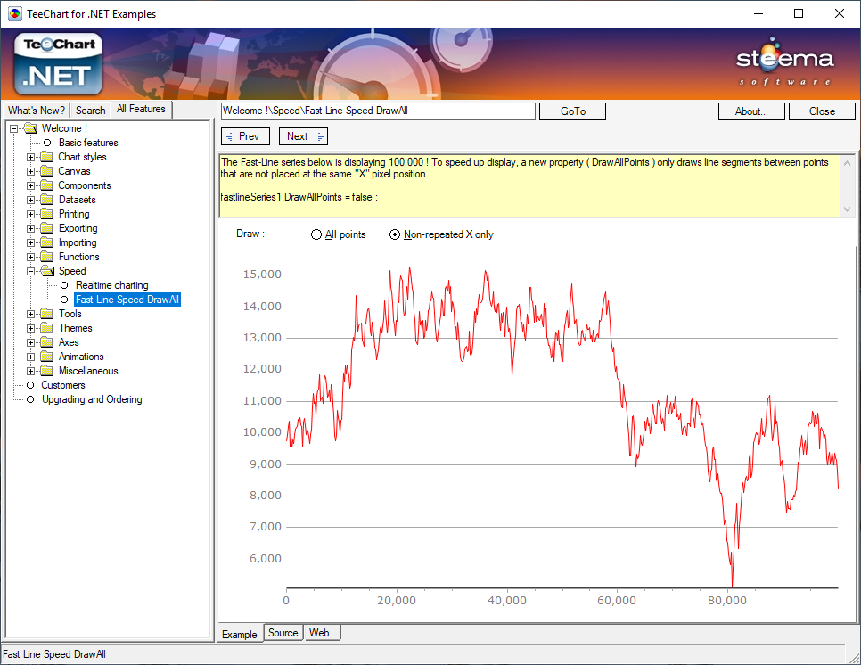

Re: How to optimize line series performance
Post by Christopher » Mon Mar 18, 2019 7:39 am
Hello!
with reference to the TeeChart Examples demo which you can download from GitHub here, there are two strategies you can try, one specific to the FastLine series and the other available for all TeeChart series types:
and
