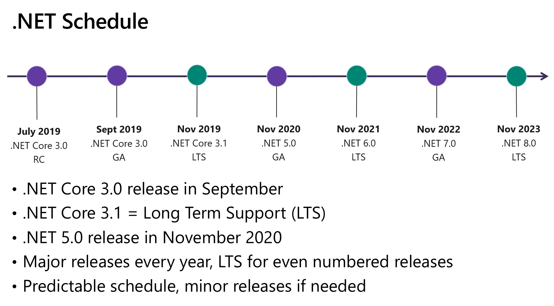

Not at the moment, no. As far as we understand from this blog post here, the roadmap for .NET Core/.NET looks like this:
We here at Steema Software are committed to complying with this timeline, and will have versions of TeeChart.NET ready for the Release Candidate of .NET Core 3.0 due in July 2019. We will be in touch with you personally as soon as we have a version of TeeChart.NET for .NET Core 3.0 which we feel is ready for client testing.

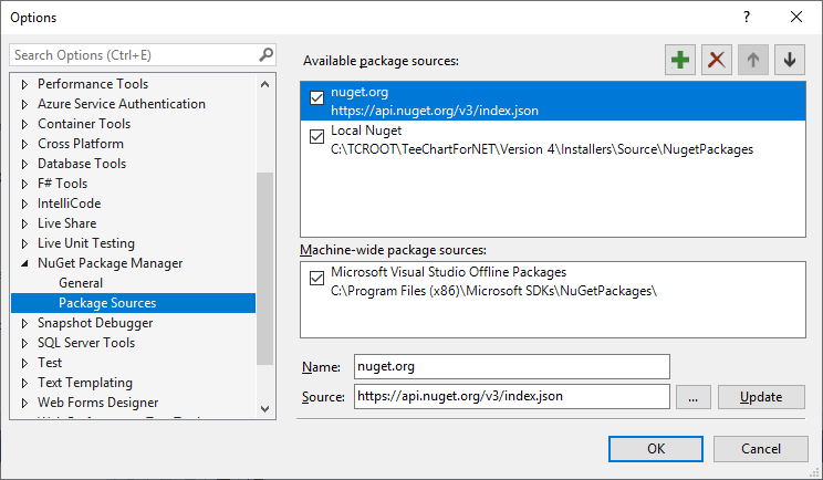

We've created a test NuGet package for .NET Core 3.0 preview 5 Windows Forms which you can download from here. You will be able to install this NuGet package into your version of Visual Studio by copying it to a local NuGet package source:
Do please let us know how your tests go.

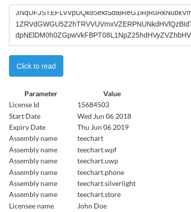

Try putting your license into the following page:
https://www.steema.com/linkIn/License_information_check
This is what I get with a dummy license:
Screenshot from 2019-08-09 09-25-08.png (32.92 KiB) Viewed 44617 times
This license will not work with Steema.TeeChart.NETCore.WinForm 4.2019.6.4 (note the license is valid by two days) because the 'Assembly name' of 'teechart.winform' is not listed. If your license does not have 'teechart.winform' listed it won't work either. Obtaining a new TeeChart.licenses file with 'teechart.winform' listed is easy to do by requesting one from sales@steema.com with your license details.
