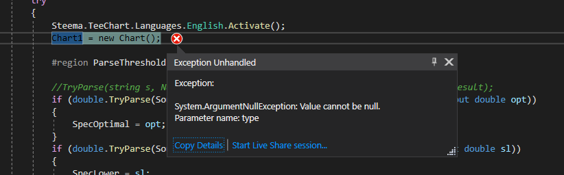

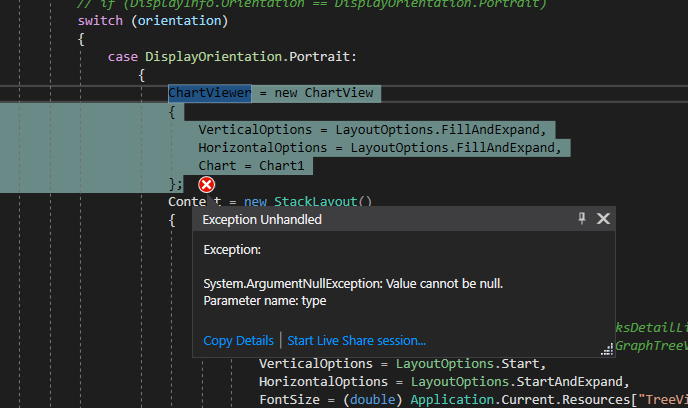

Below are the screenshots. Visual Studio 2019 (version 16.16) gives the exception shown, but still proceeds and renders the data without issue. all functionality works. but it gives this error. I've looked through the initVars() code that the Chart() function calls but don't see anything obvious. I don't see anything that could be an obvious cause for ChartView() either.
Also using Steema.TeeChart.NET.Xamarin.Forms version 4.2019.7.3.

does this happens on specific platform ?

Only in Android. iOS doesn't occur.

ok, we've been able to reproduce the problem here. We're investigating what is the cause. Until we found where the problem is and publish a new maintenance release, please get the previous package version from nuget.

This issue still occurs, unfortunately, on version 4.2019.7.12.

Also, The ArgumentNullException has stopped occurring, but I'm not sure why. it still occurred after the update and now it is not, using 4.2019.7.12.

It started giving the exception again on 4.2019.9.10. It doesn't crash but is reported.

ok, thanks for the advise. We're going to do some tests here again with the latest version in order to find what could be the cause.
