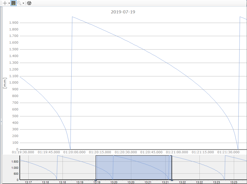

I've got a problem with the width of the ScrollPager and I don't know how to fix it.
When I activate the ScrollPager the Chart is longer than my WinForm. But when I check the width within the Debugger it says that it is the same as before. Take a look at the pictures below.
Do you have a clue?
Thanks in advance!
ScrollPager too long

I've tried to recreate your project using the following code:
Using this code I obtain the following:
The only difference in Chart size I can appreciate here is that the Legend appears in the first Chart but doesn't appear when the ScrollPager is removed - this does affect the Chart width. Is this the issue you are referring to? If not, could you please modify my code above so I can reproduce your issue here?

Hi Christopher,
thats right, the legend doesn't appear when the ScrollPager is removed. But this problem I already solved!
I just use TChart1.Legend.Visible = True when the ScrollPager is removed.
But that is not my problem now. There has to be an option that extend my TChart as soon as I activate the ScrollPager.
So I think I just have to check my Code and try to find the cause.
Thank you very much and if you got an idea, just let me now.
Best regards!

I'm afraid I'm still not entirely sure what your problem is - in the example I sent you above, can you see the problem occurring? If you can, could you please describe it to me - if you can't, could you please modify the example code so I can reproduce the problem here.LebbingUser wrote: ↑Mon Aug 12, 2019 7:02 amBut that is not my problem now. There has to be an option that extend my TChart as soon as I activate the ScrollPager.

Hi Christopher,
sorry for the opaque description of my problem.
But I got good news, I solved the problem!
Somehow the chart width increased by activating the ScrollPager. So the TChart was wider than my WinForm.
Now I've reduced the chart width and everything seems to be okay.
Thank you very much for your help!
Best regards!
