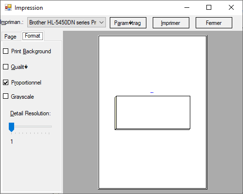

Which version of version 2 did you use, out of interest? In the source-code version of version 2.0.3020.18391 (8th April 2008), that dialogue in French looked like this:
I ask, because maybe in a later version of version 2 these French translations were also there.
