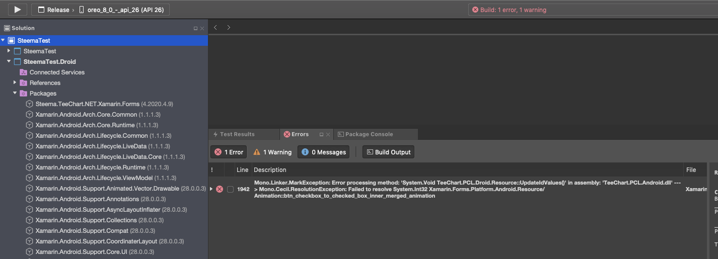

Post by Bank Van Breda » Tue Apr 14, 2020 12:47 pm
Still not working with new nuget.
Do we need to config something on our end?

Pep
Posts: 3316
Re: Unable to build AOT version of Android app
Post by Pep » Tue Apr 14, 2020 4:00 pm
I cannot reproduce the problem here. In order to take a look and try to find a solution, would you be so kind to attach a simple example in a new reply or send me directly to my email pep@steema.com ?
