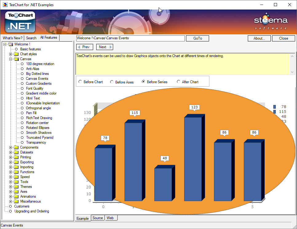

You're best bet would be to use the Canvas Events - the following is a screenshot from the Feature Demo on GitHub:
You can use these canvas events to draw anything to the chart - lines, shapes (circles, rectangles) - basically anything TeeChart can draw. To draw something at a specific series value, you can use something like this:

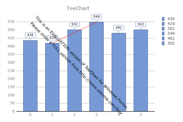

            var bar = new Bar(_tChart.Chart);
            bar.FillSampleValues();
            _tChart.AfterDraw += _tChart_AfterDraw;
            void _tChart_AfterDraw(object sender, Graphics3D g)
                //draw from max to min
                var maxIndex = bar.YValues.IndexOf(bar.YValues.Maximum);
                var minIndex = bar.YValues.IndexOf(bar.YValues.Minimum);
                var minPoint = new Point(bar.CalcXPosValue(bar.XValues[minIndex]), bar.CalcYPosValue(bar.YValues[minIndex]));
                var maxPoint = new Point(bar.CalcXPosValue(bar.XValues[maxIndex]), bar.CalcYPosValue(bar.YValues[maxIndex]));
                g.Pen.Color = Color.Red;
                g.Line(minPoint, maxPoint);
Which here gives me:
