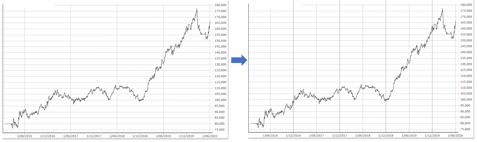

I'm pretty new to teecharts. I created a chart but for some reason the vertical line spacing is skipping one date. Basically this is what I want it to look like

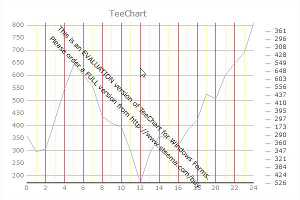

Post by Christopher » Wed Jun 10, 2020 11:15 am
Apologies for the lateness of this reply. In TeeChart we have a Grid and a MinorGrid for each axis - so code such as this:
            var line = new Line(_tChart.Chart);
            line.FillSampleValues();
            var bottom = _tChart.Axes.Bottom;
            bottom.Grid.DrawEvery = 1;
            bottom.Grid.Color = Color.Red;
            bottom.Grid.Visible = true;
            bottom.MinorGrid.Color = Color.Yellow;
            bottom.MinorGrid.Style = System.Drawing.Drawing2D.DashStyle.Dot;
            bottom.MinorTickCount = 1;
            bottom.MinorGrid.Visible = true;
Will give us:

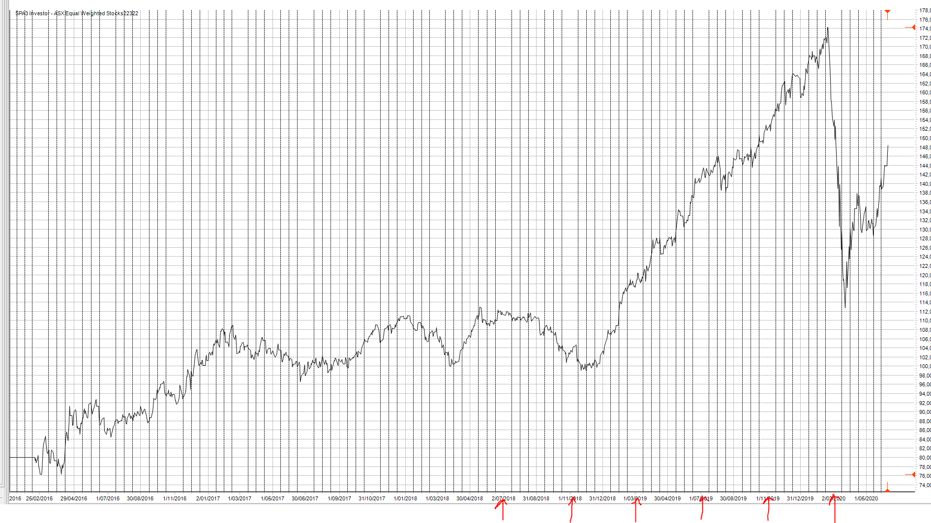

Post by sws » Thu Jun 11, 2020 3:39 am
Thank you for responding. I tried to enable the minorgrid
but this is what I got, if you notice, the vertical line I want is still missing (red arrow)
Re: How to set the vertical line spacing
Post by Christopher » Thu Jun 11, 2020 8:11 am
What happens when you add in all the code that refers to Grid and MinorGrid on the bottom axis? DrawEvery is set to 2 by default; maybe it's 1 that you need.

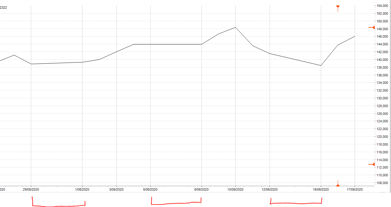

Another thing related to vertical lines. When I zoom in I got this non equal spacing axis lines (see red lines which are bigger), How do I make sure these has the same spacing.
Post by Christopher » Thu Jun 18, 2020 7:52 am
How are you adding values into your series?

Post by Christopher » Fri Jun 19, 2020 9:05 am
Hello!
still not sure about this one - maybe it's the values in your data[] object, becuase when I use code such as this:
            var rnd = new Random();
            var line1 = new Line(_tChart.Chart);
            var day = DateTime.Today;
            for (int i = 0; i < 100; i++)
                line1.Add(day, rnd.Next(1, 100));
                day = day.AddDays(1);
            _tChart.Axes.Bottom.Grid.Visible = true;
            _tChart.Axes.Bottom.Grid.DrawEvery = 1;
I can zoom repeatedly without reproducing your issue. Do you see your issue with the code above? If you don't, could you please modify the code above so I can reproduce your issue here?
