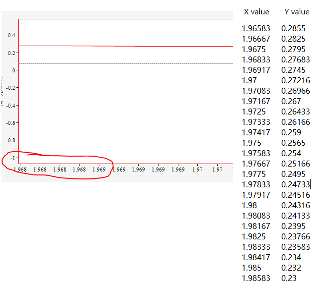

The line is composed of continuous points. When I zoom the chart, duplicate numbers appear on the axis. How should I avoid this situation.
The normal chart is shown in 2.png, and the zoomed chart is shown in 3.png. The figure below shows some of the data.

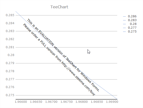

You can set the ValueFormat of series points and axis label values to any of the Standard or Custom numeric format strings, e.g.
            _tChart.Aspect.View3D = false;
            var fastLine = new FastLine(_tChart.Chart);
            fastLine.Add(1.96583, 0.2855);
            fastLine.Add(1.96667, 0.2825);
            fastLine.Add(1.9675, 0.2795);
            fastLine.Add(1.96833, 0.27683);
            fastLine.Add(1.96917, 0.2745);
            _tChart.Axes.Bottom.Labels.ValueFormat = "N5";

Thanks for your suggestions, the problem was successfully solved.
