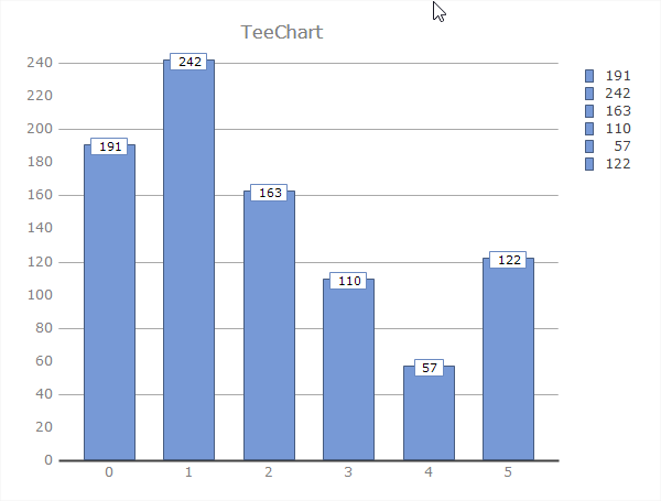

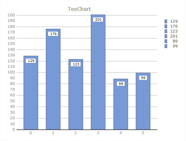

Recently we upgraded TeeChart from 2015 to 2020 version. We noticed following difference when showing marks on bar:
Before:
[img]https://ibb.co/9w83z8Z[/img]
After:
[img]https://ibb.co/tCJSbbM[/img]
New 'Tails' feature is configurable and can be switched-off. One more difference is lowered marks inside the bar.
Is it possible to get them to original position?
We use 'end' location of marks.
The workaround I found is:
- switch-off 'Marks on bar' property;
- set Marks->Arrow->Distance property to '-28'.
Doing so I got marks on similar position, but I wonder whether there is a 'legal' way to achieve it.

Is it possible to also place marks a bit higher within the bar?
At this sample it's not a big deal, but in our case marks have multiple lines and get cut when bar is almost 0 height.

if you're not entirely happy with the position at which 'MarksOnBar' leaves the SeriesMarks, you can turn it off and modify their position using ArrowLength, e.g.
        Bar _bar = new Bar();
            _tChart.Series.Add(_bar);
            _bar.FillSampleValues();
            _bar.Marks.ArrowLength = -10;
            _bar.Marks.TailStyle = MarksTail.None;
            //_bar.MarksOnBar = true;

Ah, sorry, I must have misread your first message and missed your reference to Marks.ArrowLength! Either way, although the negative numbers may look a little strange, this is the most 'legal' way I can find to modify the position of SeriesMarks when Marks.AutoPosition is true.
