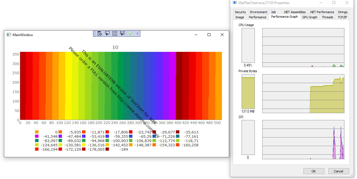

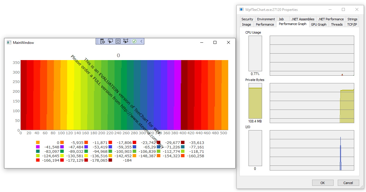

Post by HCCKPM_2020 » Thu Oct 01, 2020 7:46 am
Here you will find a sample project: https://hcckpm-my.sharepoint.com/:u:/g/ ... w?e=3Y6gGB
After each click the memory usage will grow. It will fall down after a few clicks but not to the starting point.
In the sample we use the ColorGrid.
We also tested the same behavior on a second system. That's the reason why it is not registered.
We also used the latest nuget downloadable version from September.
Best regards,
HCC/KPM

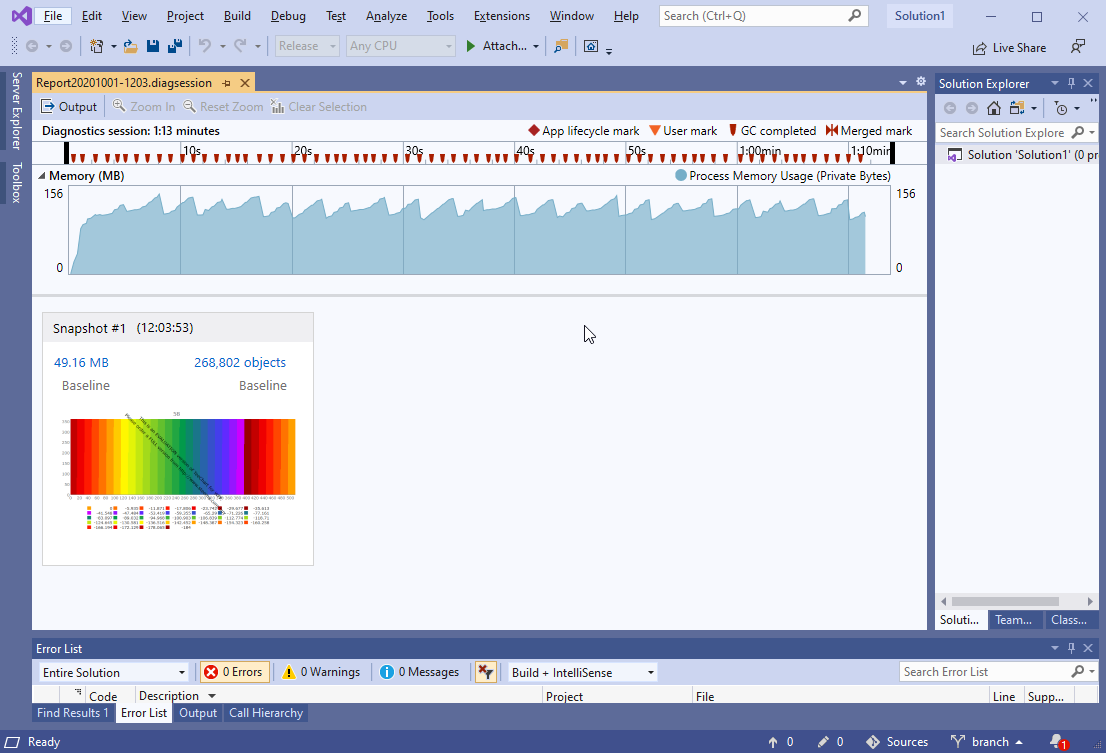

I then ran this code in a Memory Usage diagnostic session as detailed here using the latest publicly available version of Visual Studio 2019. I've uploaded the results here in the form of a *.diagsession file which you can open in Visual Studio 2019. The results look like this:
As you can see, this specific diagnostic session has failed to detect any kind of memory leak in the code.
