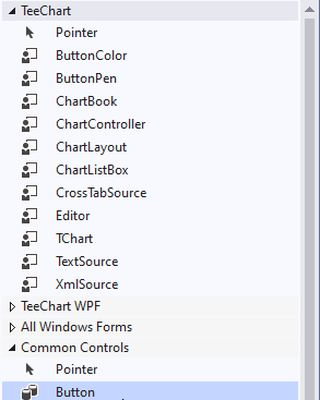

Again, this functionality works as expected here:

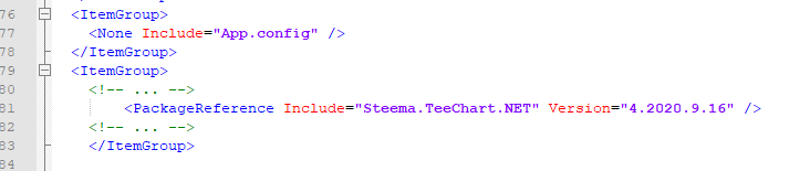

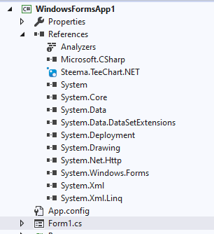

Don't know what is wrong with my VS installation (again?) but looks like I've found a workaround for me: after adding Steema.TeeChart.NET nuget via PackageReference .csproj file is not altered for some reason (PackageReference xml-tag is not added). But if after that I simply create for example an instance of TChart class (and add apropriate using above) - PackageReference xml-tag is instantly added to .csproj and TeeChart controls are not populated to VS Toolbox.
Strange that other nuget packages (Newtonsoft.Json, Microsoft.EntityFrameworkCore.SQLite, etc.) are working as expected and add PackageReference xml-tag to .csproj file instantly.
