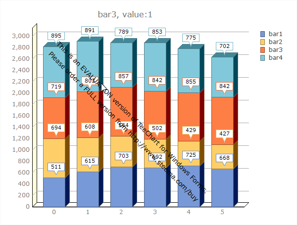

As I can see BarSeries.Clicked() checkes whether cursor is above front, right or top face of 3D bar. But it is not respecting situation when stacking bar point overlaps top face. It still return that cursor is above first bar point decpite of that fact that user actually don't see it's top face. User is seeing second bar front and right face on that position.

Your sample don't need any modification - at also have the same bug:
It still showing bar2, value:5 when cursor is already above bar3 (cyan). I need to move cursor higher to change it to bar3, value:5.
That is because component thinks that cursor is above top face of bar2 (orange) and ignores the fact that bar3 (cyan) hides that top face.
