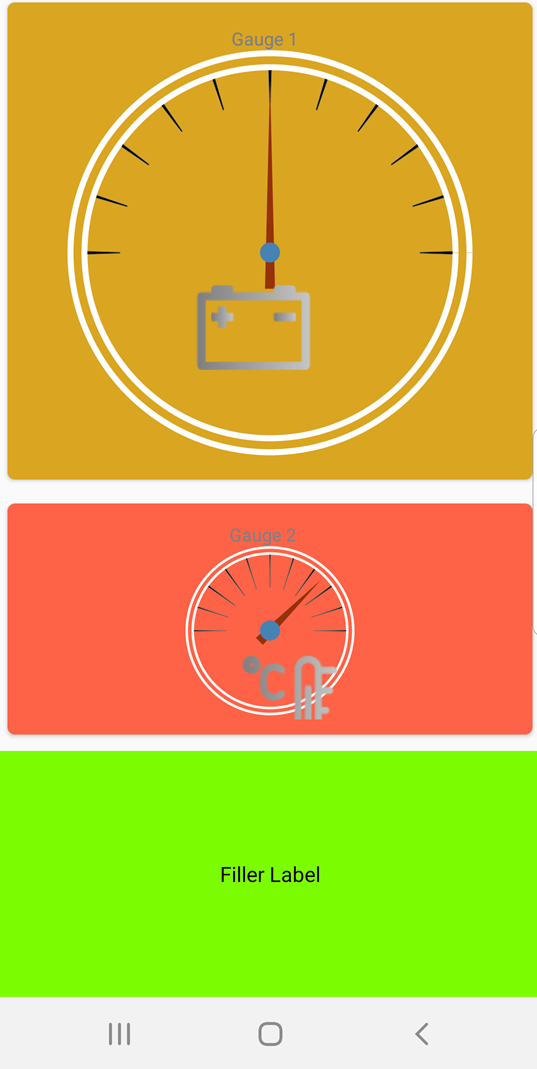

I have a requirement to draw an image on top of a circular gauge at a position relative to the gauge and for the image to scale in size when the ChartView changes size, but to keep it's position relatively within the circular gauge (chart view).
Using information from other posts in the forum, and the TeeChartNetExamples code, I use the Chart_AfterDraw event to draw the image, but my issues are...
1) How to keep the image size scaled relative to the gauge
2) How to position the image, but I would be able to do this if I could define the image size
I have written a test app, showing the same user control in 2 different sizes.

I assume the solution is in one of the g.Draw overloads but I can't find the correct syntax.

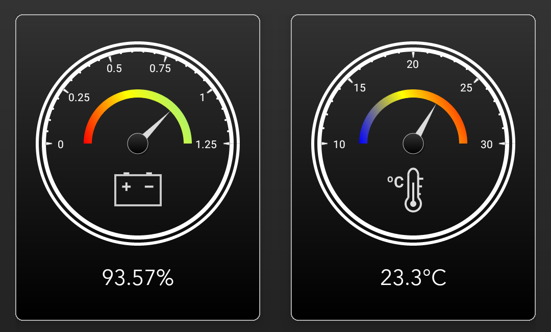

The target look is this...

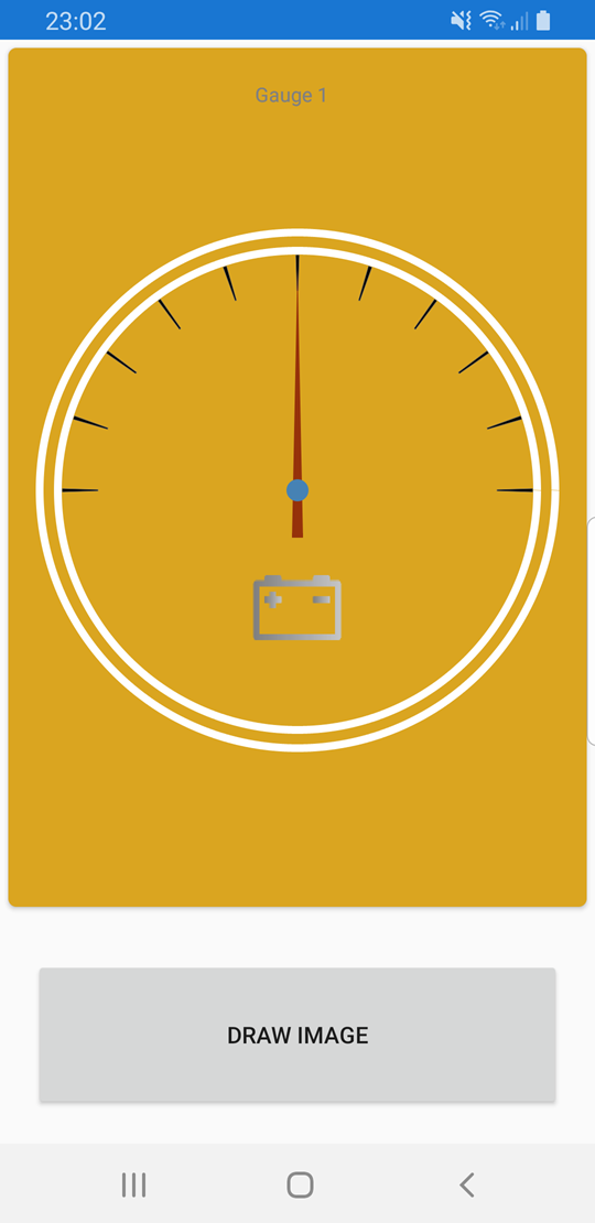

However, the issue I now have is that the image is not always shown. When the app starts, the Chart_AfterDraw event fires and the code to draw the image is run but the image is not shown. If I click the "DRAW IMAGE" button, which runs the same code, then the image is drawn OK.
Randomly pressing on the gauge, which causes the Chart_AfterDraw event to fire, does sometimes result in the image being drawn but on the next press of the gauge the image disappears.
Obviously, within the main production App, I need the image to draw without having to manually press a button (e.g. when the app is backgrounded & then resumes)
I have attached a zip file with the small sample solution which demonstrates this issue.

This new code for the thermometer graphic is excellent & far more than I expected you to provide.
I have now integrated the battery & thermometer graphic drawing code into my main App (see screenshot below) & will be able to move this into production.
Gauge Screenshot (with drawn graphics).png (69.82 KiB) Viewed 28187 times
Many thanks for your commitment in helping to resolve this issue :)
