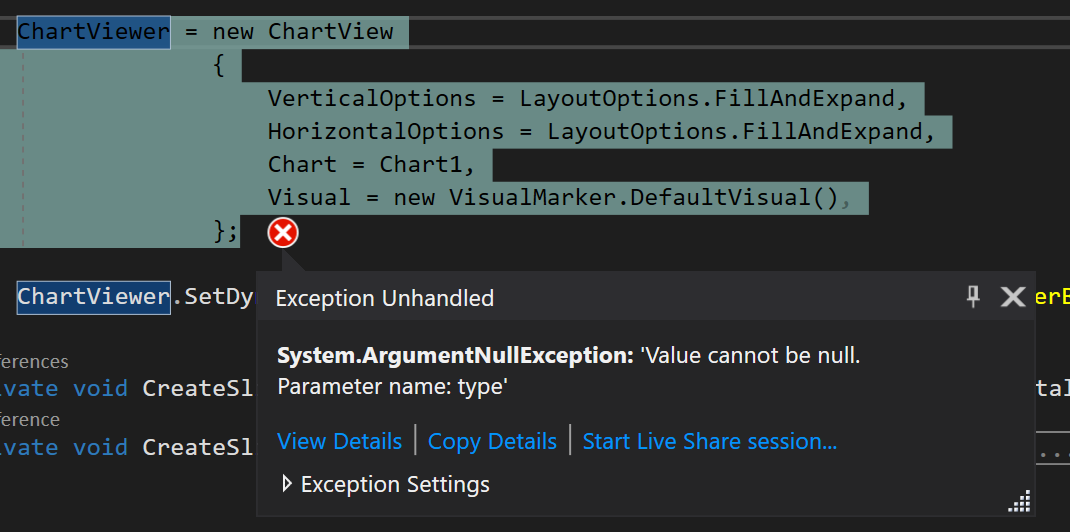

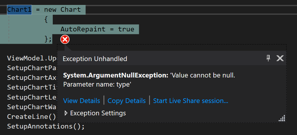

With Xamarin.Forms Version 5.0.0.1874, Version 4.8.0.1821, Version 4.8.0.1687 and Version 4.8.0.1560, graphs break on both Android and iOS. it displays if you catch the exceptions but does not render correctly: popup annotations are broken and don't show, pinch and zoom is gone, etc.

- chartviewer.PNG (70.52 KiB) Viewed 92463 times
- chart.PNG (59.04 KiB) Viewed 92463 times
