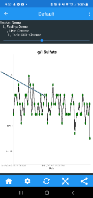

Annotation Tool Popup doesn't respect placements. Width and Height are both zero, but the bounds show correct sizing. It always renders off the screen, no matter what placement ( left ( x ), top ( y ) ) I set it to.
What is displayed:
Current settings with the above view:
Previous possible related issue

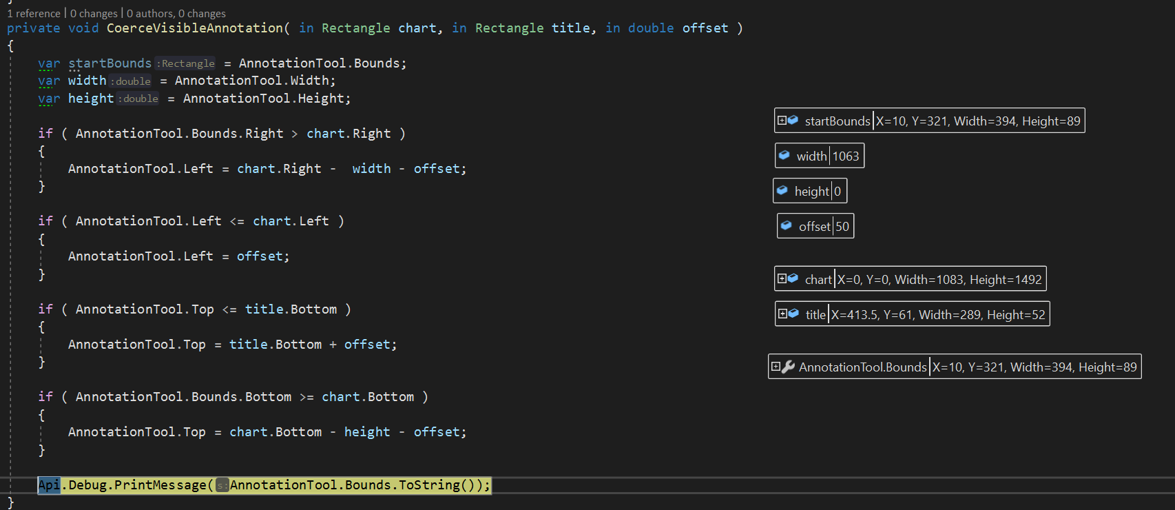

	public static void CoerceVisibleAnnotation( this Annotation tool, in Rectangle chart, in Rectangle title, in double offset )
		Rectangle startBounds = tool.Bounds;
		double width = tool.Width;
		double height = tool.Height;
		if ( tool.Bounds.Right > chart.Right ) { tool.Left = chart.Right - width - offset; }
		if ( tool.Left <= chart.Left ) { tool.Left = offset; }
		if ( tool.Top <= title.Bottom ) { tool.Top = title.Bottom + offset; }
		if ( tool.Bounds.Bottom >= chart.Bottom ) { tool.Top = chart.Bottom - height - offset; }

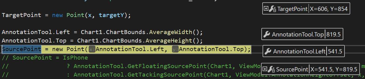

private void SetPoints( in double x, in double y )
	// AnnotationTool is a Steema.TeeChart.Tools.Annotation
	AnnotationTool.ConfigureAnnotations(ViewModel.FloatingAnnotations, ViewModel.SelectedItemDescription);
	if ( !AnnotationTool.Active ) { return; }
	Chart1.Title.Visible = ViewModel.FloatingAnnotations;
	if ( !ViewModel.FloatingAnnotations )
		TargetPoint = new Point(x, y - GraphViewModel.ANNOTATION_OFFSET);
		SourcePoint = new Point(AnnotationTool.Left, AnnotationTool.Bounds.Bottom);
		return;
	bool leftBound = x <= Chart1.ChartBounds.AverageWidth();
	bool topBound = y <= DataLine.LocalAveragePos(out double minVerticalValueHeight, out double maxVerticalValueHeight, true);
	double targetY = topBound
						 ? y + GraphViewModel.ANNOTATION_OFFSET
						 : y - GraphViewModel.ANNOTATION_OFFSET;
	TargetPoint = new Point(x, targetY);
	AnnotationTool.Left = Chart1.ChartBounds.AverageWidth();
	AnnotationTool.Top = Chart1.ChartBounds.AverageHeight();
	SourcePoint = new Point(AnnotationTool.Left, AnnotationTool.Top);

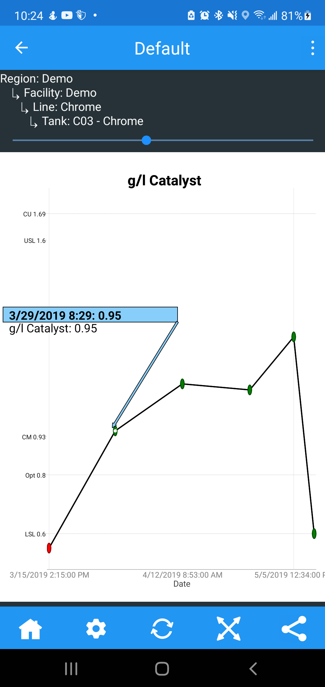

And this is the result:
