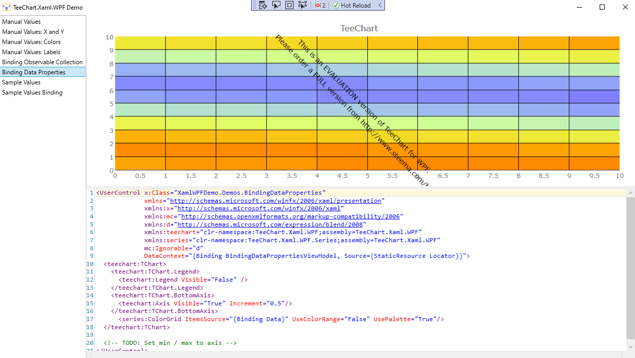

Okay, I've made a change at the GitHub example here which you will now be able to run:
Screenshot from 2021-04-27 10-51-00.png (108.94 KiB) Viewed 46123 times

I changed your BindingDataPropertiesViewModel constructor slightly to show a problem I am seeing. I expect to see a ColorGrid where both axis range from (-1 to 1). Instead I see something that is partially displayed in the upper right half. In this example dx=0.2 and dz=0.1. Therefore, the axis ideally should be x=-1,-0.8,-0.6,...,0.8,1.0 and z=-1,-0.9,-0.8,..., 0.9, 1.0. However, due to numerical precision, the axis appears to be irregular which is causing problems for ColorGrid.
public BindingDataPropertiesViewModel()
    int nx = 11;
    int nz = 21;
    double dx = 2.0 / (double)(nx - 1);
    double dz = 2.0 / (double)(nz - 1);
    Data = new Series3DData[nx*nz];
    int k = 0;
    for (int i = 0; i < nx; i++)
        double x = -1.0 + i * dx;
        for (int j = 0; j < nz; j++)
            double z = -1.0 + j * dz;
            Data[k] = new Series3DData { X = x, Y = Math.Sin(k / (double)(nx * nz) * Math.PI * 2) * Height, Z = z };
            k++;
    //_timer = new DispatcherTimer(DispatcherPriority.Normal) { Interval = TimeSpan.FromSeconds(0.05) };
    //_timer.Tick += OnTick;
    //_timer.Start();
