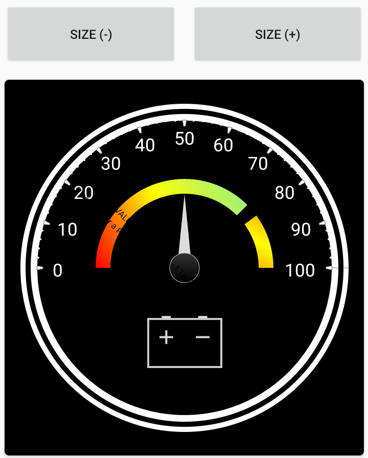

I am trying to write code to re-size aspects of a circular gauge control when the gauge itself is resized. My code does work, but only when the gauge control is pressed after being resized. I assume I am not calling my resize code in the correct event (currently calling in the AfterDraw event) but I cannot determine the best solution.
I have written a small test solution (attached) to demonstrate what I am trying to achieve.

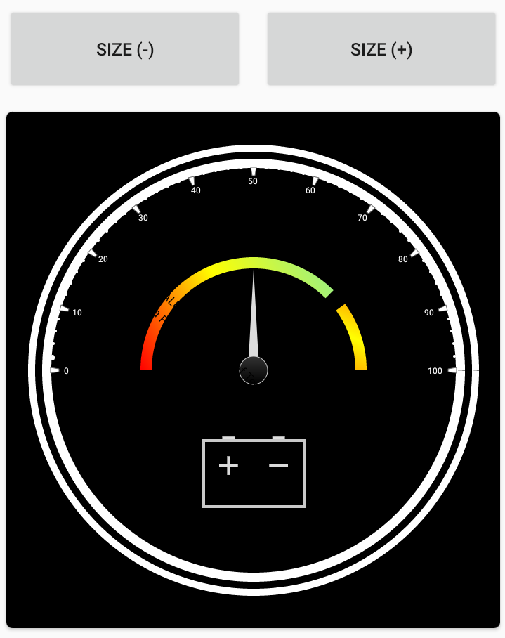

In my test App whenever the SIZE button(s) are pressed, the gauge control does resize but the label font, line band & center point only size correctly when the gauge control is subsequently pressed.
Incorrect result
Correct result (after gauge control pressed)
All feedback & assistance greatly appreciated

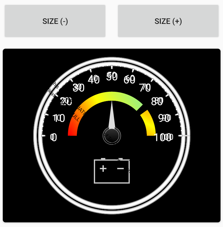

I have added the Chart.Chart.InternalDraw() method call to the end of the Resize method & while it does re-draw the font, centre point & colour band in the correct size it leaves the original (incorrectly sized) chart elements in position, creating a "shadow" effect - see image.
Should I be calling some sort of repaint or invalidate method before the InternalDraw method to remove the old graphics?

yes, you're correct, it seems to be a repaint problem. I'll add as a bug on our bug list in order to be addressed.
In meantime I found a solution, it's to use the OnBeforeDraw event to hide the axis labels and then make them visible again once these have been resized :
        // Add the beforeDraw method at the CreateGauge method
        cv.Chart.BeforeDraw += Chart_BeforeDraw;
        private void Chart_BeforeDraw(object sender, Steema.TeeChart.Drawing.Graphics3D g)
            CircularGauge.Axis.Labels.Visible = false;
        // Add these lines at the end of the Resize method
        CircularGauge.Axis.Labels.Visible = true;
        this.Chart.Chart.InternalDraw();
