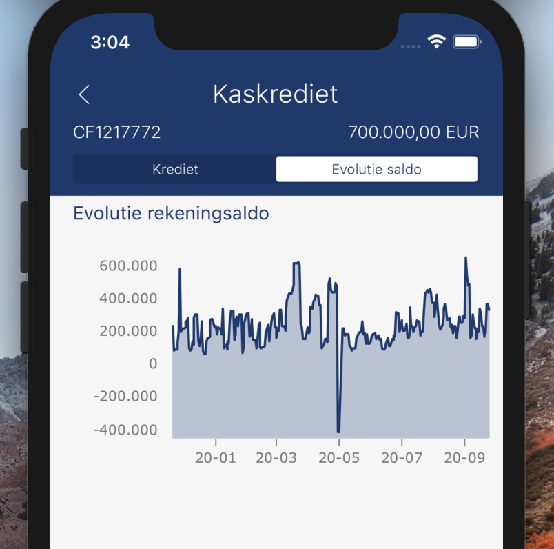

We use the AreaLineChart in our Xamarin Forms application.
But no matter what we set the WidthRequest to, there is always more left margin white space than on the right side.
We set the control to Center.
Cfr screenshot.
How can we get equal margins?
Cfr screenshot.
- AreaLineChart.png (294.4 KiB) Viewed 27509 times

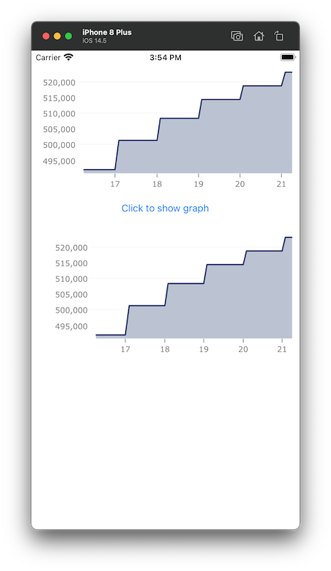

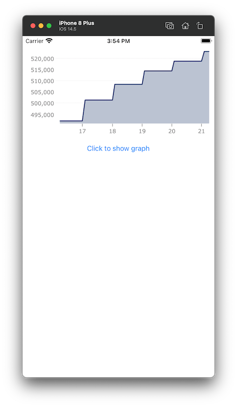

Here I load the same graph twice on the page, the first one is just like your sample the second one has a bool bound to IsVisible and will become visible with the button click.
This will render it smaller! Cfr screenshots.
Do you still need extra info on code? I can supply the example if needed.
- Screenshot 2021-05-21 at 15.54.31.png (92.05 KiB) Viewed 27467 times
- Screenshot 2021-05-21 at 15.54.28.png (76.73 KiB) Viewed 27467 times

Re: Left margin AreaLineChart
yes, you're correct, I'm able to reproduce the problem here.
For the moment still not found what's the cause of this. We will review more carefully in order to find a solution.
In meantime, would be an option to you to set invisible via code instead of doing it via binding ?
