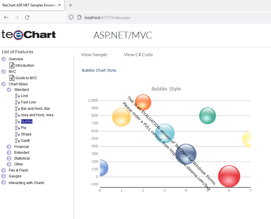

I've just modified this example so it can run with the latest version of TeeChart's NuGet. You may need to deinstall the NuGet first and then reinstall it to get it to work, as otherwise the necessary TeeChart.dll will not get put into the website's Bin folder.
Once you've got it running, you should see the watermark, i.e.
Screenshot from 2021-09-20 09-57-58.png (93.21 KiB) Viewed 23527 times
The next step it to substitute in the content of the TeeChart.licenses file which you can find in the project here. The content of the file in the repo is 'PExp' - you should replace this with the string you find in your valid TeeChart.licenses file (about 1925 characters). Now rebuild the project and run - here the watermark disappears:

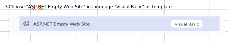

Sorry, I used Visual Studio 2019. My steps are listed in the attached Excel file.
StepsToCreateMyProject.zip

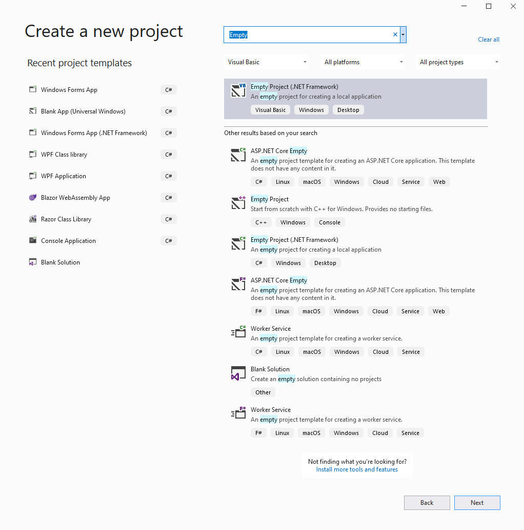

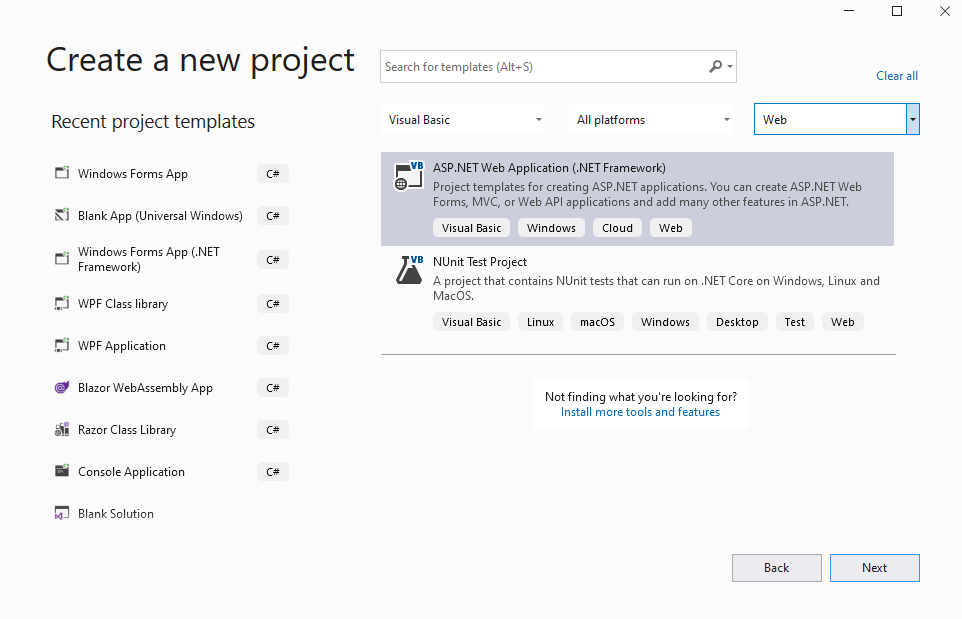

I also have Visual Studio 2019 installed, and these are the project options it gives me:
Screenshot from 2021-11-19 12-14-21.png (49 KiB) Viewed 22698 times
and:
Screenshot from 2021-11-19 12-10-02.png (74.75 KiB) Viewed 22698 times

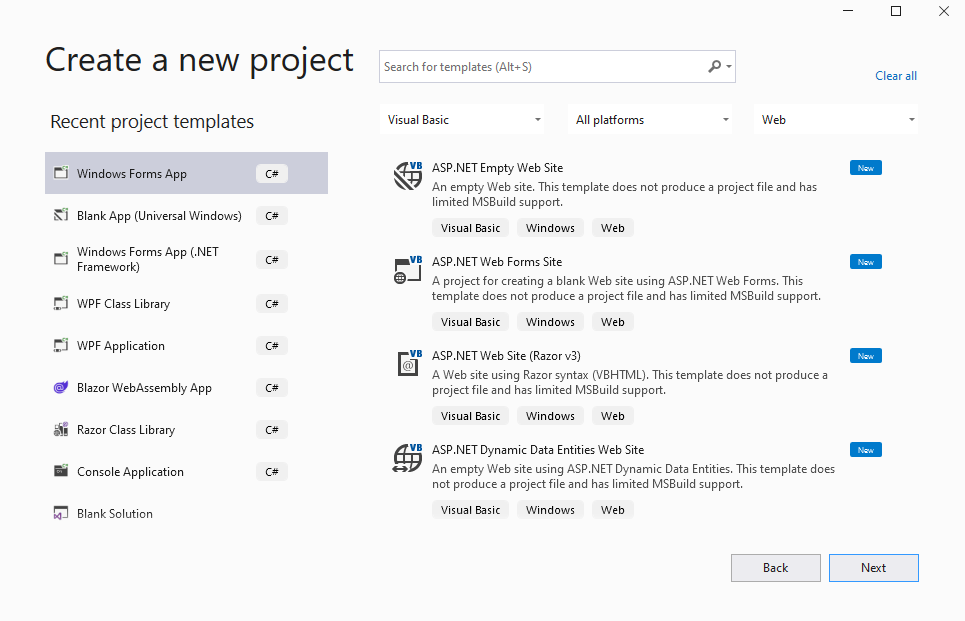

As you can see, I do not seem to have the 'ASP.NET Empty Web Site' you use:
Screenshot from 2021-11-19 12-27-58.png (16.82 KiB) Viewed 22698 times
Do you know where I can obtain this Visual Studio template from?

Re: Enable TeeChart for .NET in website project
Post by Christopher » Mon Nov 22, 2021 9:33 am

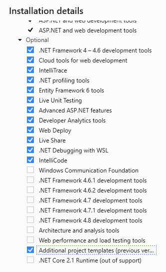

Okay, got it - I was missing the 'Additional project templates (previous versions)':
Screenshot from 2021-11-22 09-48-02.png (23.85 KiB) Viewed 22667 times
Which gives your empty project template:
Screenshot from 2021-11-22 09-50-21.png (59.49 KiB) Viewed 22667 times

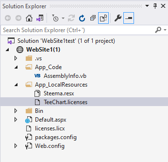

The solution to your problem therefore is to add an AssemblyInfo.vb file to your project:
Screenshot from 2021-11-22 10-31-23.png (16.8 KiB) Viewed 22667 times
The AssemblyInfo.vb file should contain the following:
Screenshot from 2021-11-22 10-32-14.png (5.21 KiB) Viewed 22667 times

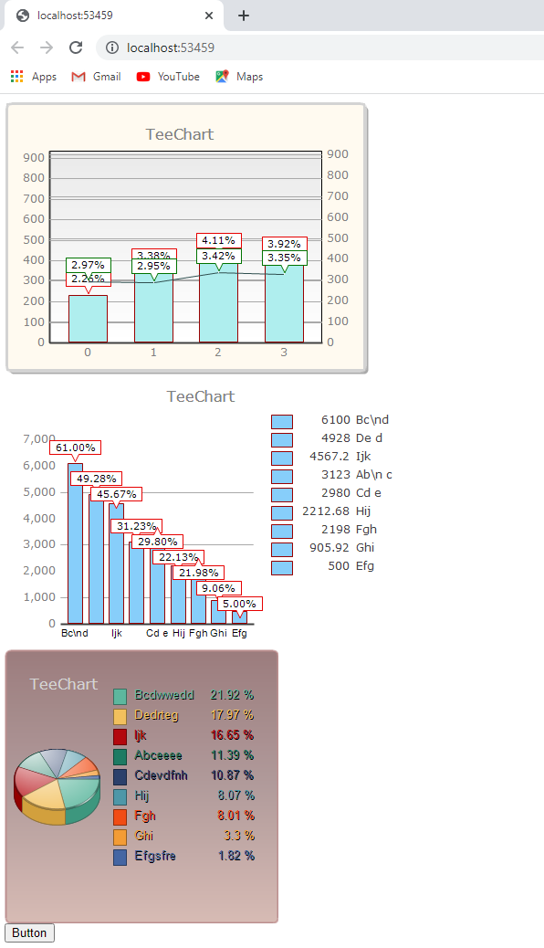

Running the project now shows Charts without the watermark:
Screenshot from 2021-11-22 10-27-39.png (68.7 KiB) Viewed 22667 times
