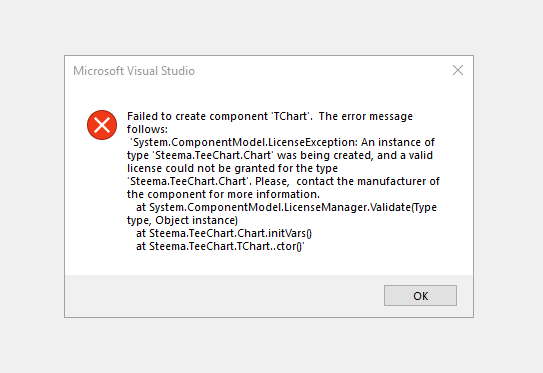

Failed to create component TChart
- Newbie
- Posts: 1
- Joined: Tue May 25, 2021 12:00 am
I am really struggling to resolve an error.
I am installing via NuGet as soon as I drag the TChart onto a winForm I get this error.
This is regardless of whether I have a license file in the project or not?

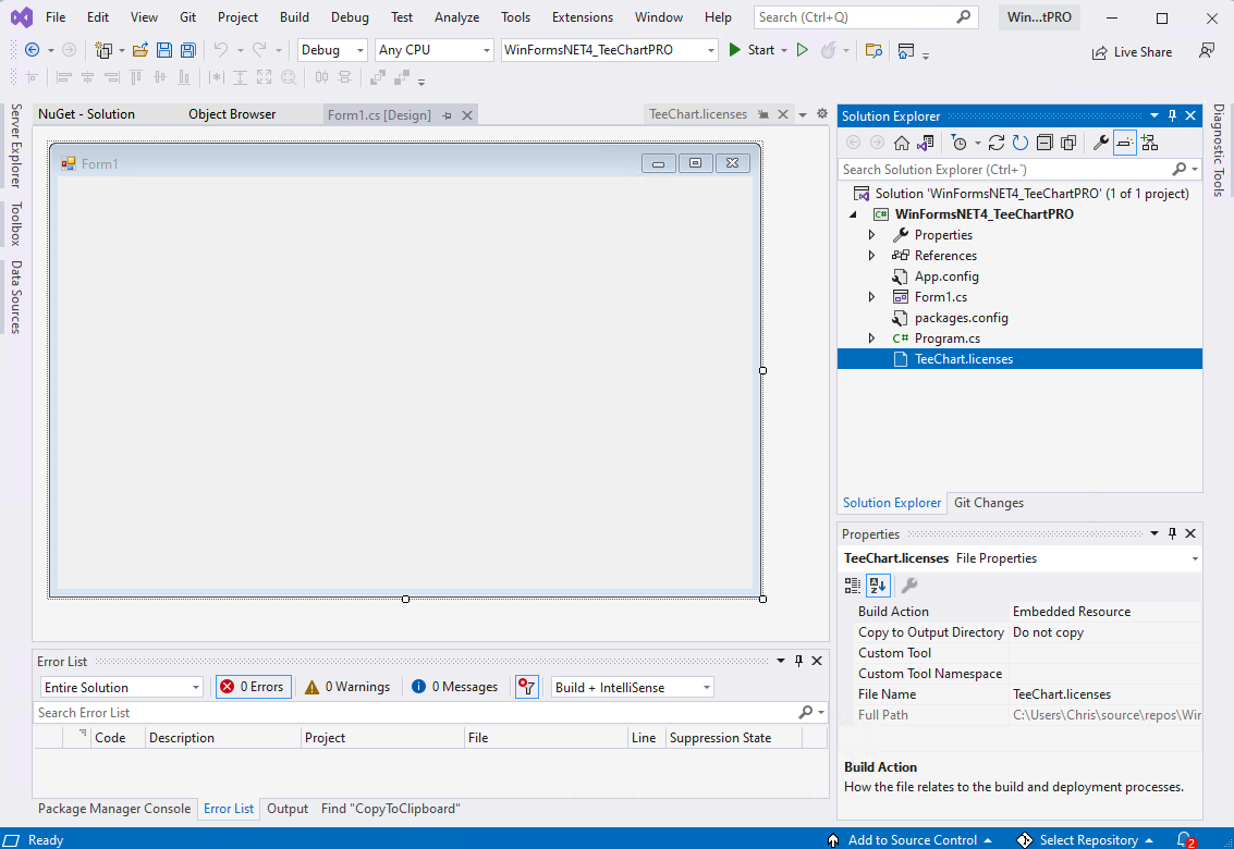

- Guru
- Posts: 1603
Re: Failed to create component TChart
We would like to know what happens when you create a new WinForms project in VS2022 with your TeeChart.licenses as an Embedded Resource, so your project looks like this: The code in the Form1.cs should look like this:
When you run this form, you should not see a watermark on your Chart.

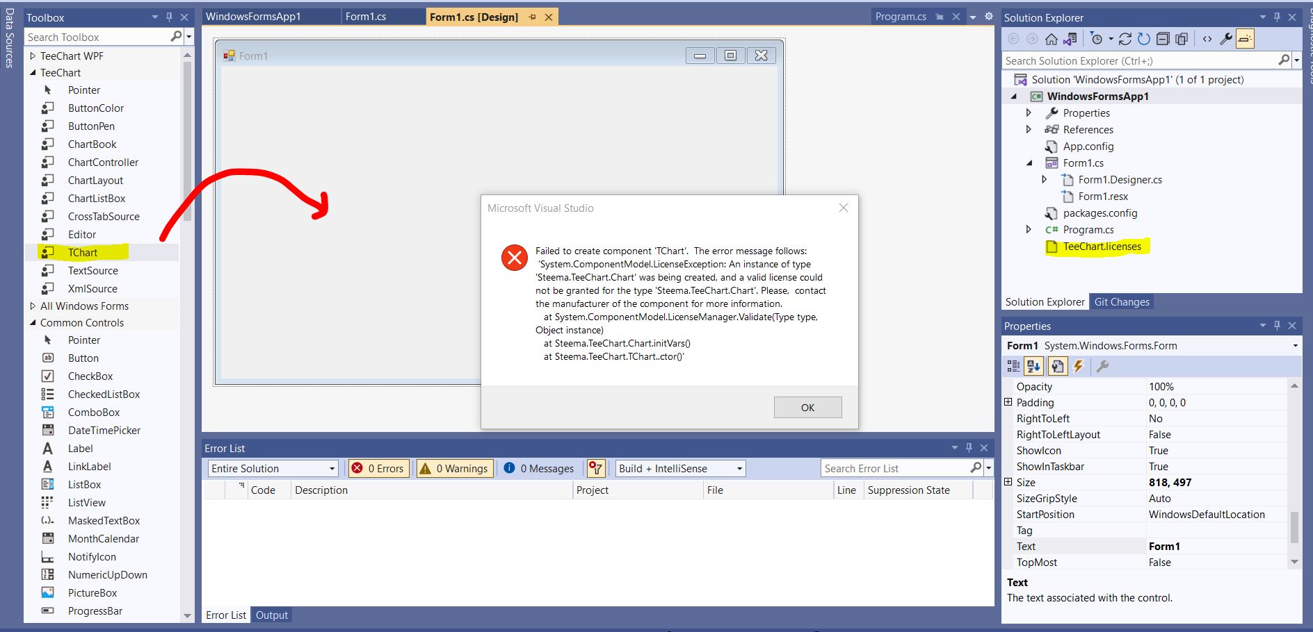

Hi Christopher!
Thanks for getting back!
Your suggestion using C# and adding the TChart element in code is working fine. The program starts and I see TChart on the form without watermark.
However, when using the VS Toolbox to draw a TChart Element on the form I get the error message.
I also get the design time error in VB.NET when trying to draw a TChart element on a form.
I will now try to add the element by code in VB.NET to see if that works.

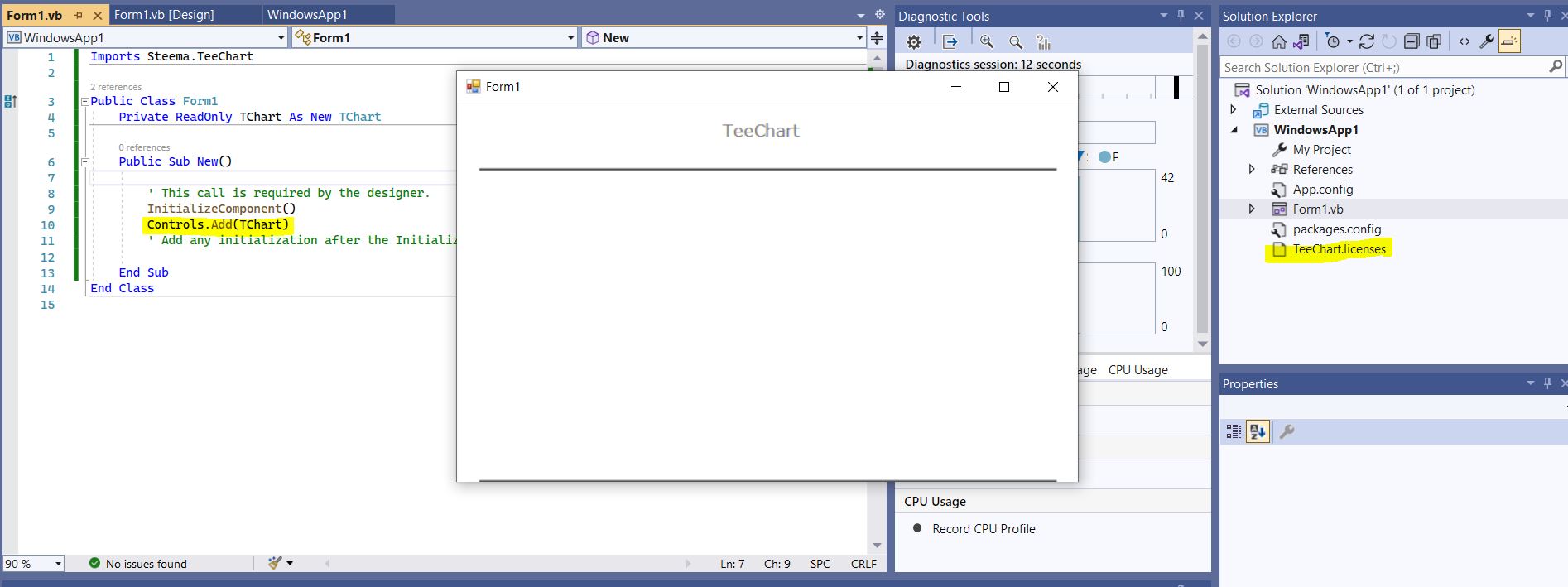

Ok, I have validated that VB.NET is also working at runtime without watermark when adding TChart in code.
The problem then seems to be related to the Toolbox Controls when adding a TChart by drawing on a form.
I hope this can be resolved quickly.
I have a project with ~15 TChart graphs added via Toolbox and this project currently does not run.
Holger
Holger

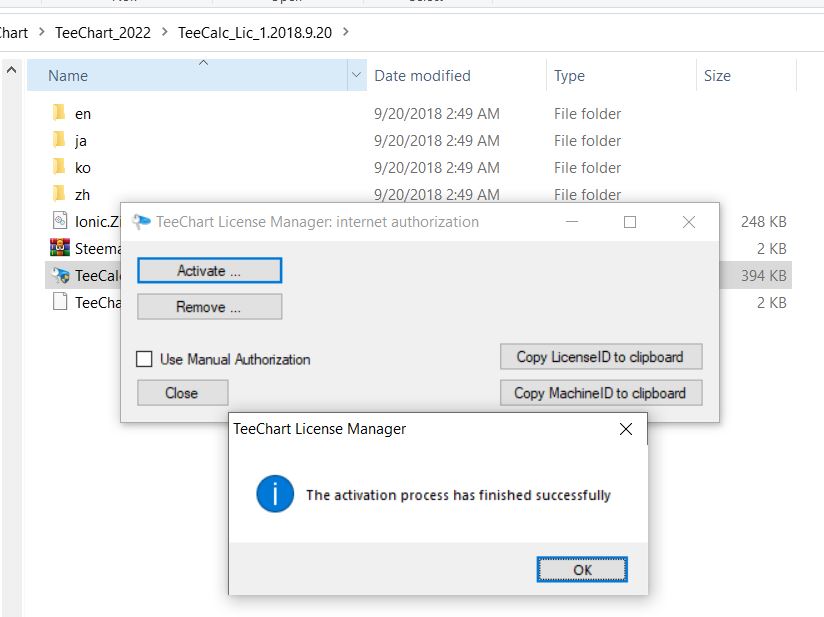

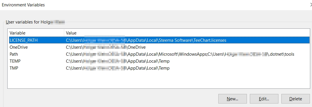

Hi Christopher!
I have run TeeCalc_Lic.exe 3x times now and it always showed correct activation.
How else would I have the TeeChart.licenses file that I add to the project?
I also checked the Windows10 LICENSE_PATH variable that is being added in the system environment variables.
Holger
Holger
- TChart_Error_#3.JPG (59.59 KiB) Viewed 15781 times
- Guru
- Posts: 1603
Hello Holger,
There is nothing stopping our clients copying TeeChart.licenses files from other machines, unfortunately.How else would I have the TeeChart.licenses file that I add to the project?
Have you tried shutting everything down, logging out of your User account and logging back in again?I have run TeeCalc_Lic.exe 3x times now and it always showed correct activation.
Hi Christopher,
To your #1.... Ok. I didn't think about that but unfortunately true.
I tried this yesterday already and have rebooted the machine 2 time already in the meantime.
Is the system environment variable correct as shown in the screenshot?
Holger
Holger
- TChart_Error_#4.JPG (128.19 KiB) Viewed 15777 times
- Guru
- Posts: 1603
Hello Holger,
that looks fine - it's more likely to be an issue with the Registry and its reading.
