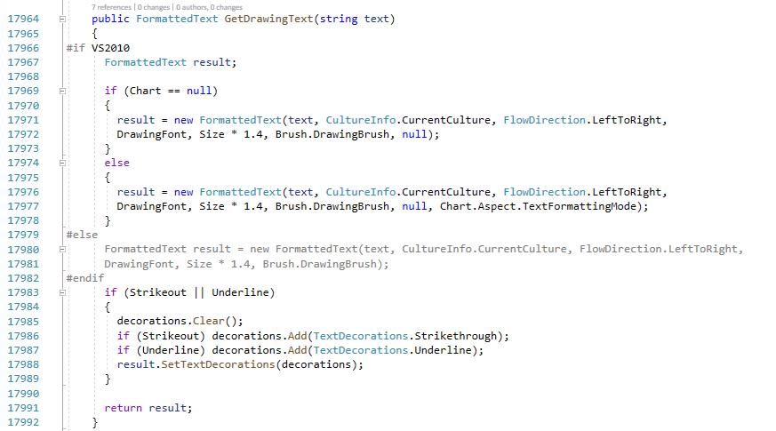

The Font.Size property does. The last TeeChart method called in the stack trace is GetDrawingText, which looks like this: If the Size is zero it will produce the error, but we do not set Size to zero anywhere in the TeeChart.WPF source code. One way to workaround this issue would be to check for zero every time this method is called, but this doesn't really get to the bottom of the issue, which is what is setting Size to zero in the first place. We would be interested in understanding the issue here, and if you're willing we could offer you temporary access to the TeeChart source-code so you could see for yourselves where this zero assignment is being made.
