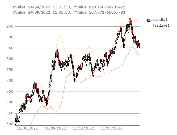

Yes, the Bollinger Bands are hidden series, but you can pull the values out with code like this (move the mouse over the top band to get the values):
      Candle series = new Candle(tChart1.Chart);
      FastLine funcSeries = new FastLine(tChart1.Chart);
      Bollinger function = new Bollinger(tChart1.Chart)
        Period = 50,
        Deviation = 2
      funcSeries.DataSource = series;
      funcSeries.Function = function;
      series.FillSampleValues(400);
      CursorTool cursor = new CursorTool(tChart1.Chart)
        Style = CursorToolStyles.Vertical,
        FollowMouse = true,
        Series = funcSeries
      cursor.Change += Cursor_Change;
      tChart1.Header.Font.Size = 10;
      void Cursor_Change(object sender, CursorChangeEventArgs e)
        if (e.ValueIndex > -1)
          System.Collections.Generic.List<FastLine> lineSeries = tChart1.Series.OfType<FastLine>().ToList();
          tChart1.Header.Text = string.Join("\n", lineSeries.Select(x => $"XValue {DateTime.FromOADate(x.XValues[e.ValueIndex])}, YValue {x.YValues[e.ValueIndex]}"));
Here this gives me:
Screenshot from 2022-05-09 11-33-47.png (33.15 KiB) Viewed 8317 times
