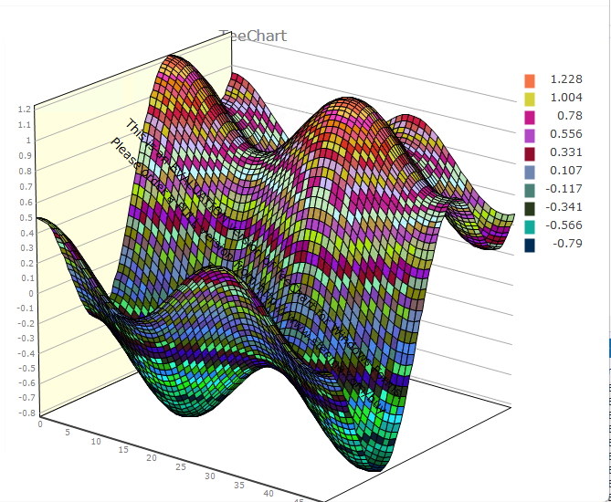

we're looking at this now, and we've got a quick question to ask you if that's okay with you. When you say that:
hkoesa wrote:
Wed May 25, 2022 4:51 am
The AddPalette function is similar to what I like to have but it does not automatically scale with Z values.
what code can we use to see what you mean? The following code generates a palette with 64 unique colours, but we can't see how the palette fails to scale with Z values. Please note that palette colours depend on Y values, not Z values, and each time we add a new colour to the palette we define the Y value up to which we want to paint in that colour:

      for (int i = 0; i < numSteps; i++)
        var step = rangeY / numSteps;
        value += step;
        surface.AddPalette(value, colors[i]);
Screenshot from 2022-07-01 13-21-13.png (377.09 KiB) Viewed 6278 times
