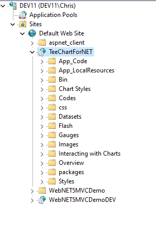

once you have the sample on the other thread working in Debug, you can publish it to IIS. The steps are:
1. Add an application to your IIS:

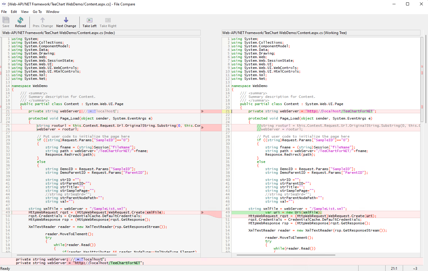

2. Modify the source code of Content.aspx.cs so it looks like this (make sure the 'webServer' variable has the same name as the IIS share):
Screenshot from 2022-05-30 14-35-55.png (195.97 KiB) Viewed 7980 times

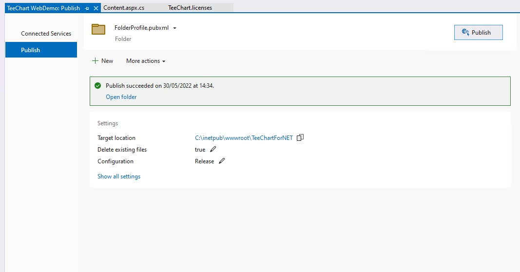

3. Use Visual Studio to publish the app:
Screenshot from 2022-05-30 14-55-00.png (22.29 KiB) Viewed 7980 times

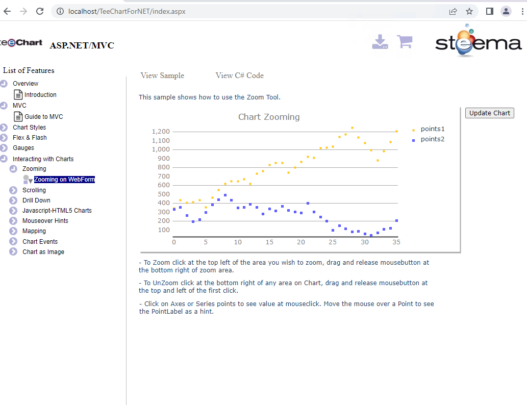

4. The app now runs in IIS without the watermark:
Screenshot from 2022-05-30 14-50-11.png (81.74 KiB) Viewed 7980 times

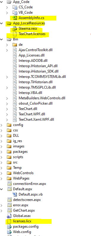

I have an old web-api application, I followed the example and added the various files for the license. In debug everything works but when I publish it I see the watermark.
I can't figure out what's missing to show the runtime license
As I'm sure you can imagine, it is extremely difficult for me to try and infer what is going on in your project by looking at that image! Is there any way you can try and cut it down to something you can put in a zip file and post on here? We need to be able to reproduce your problem here to be able to help you, I'm afraid.
