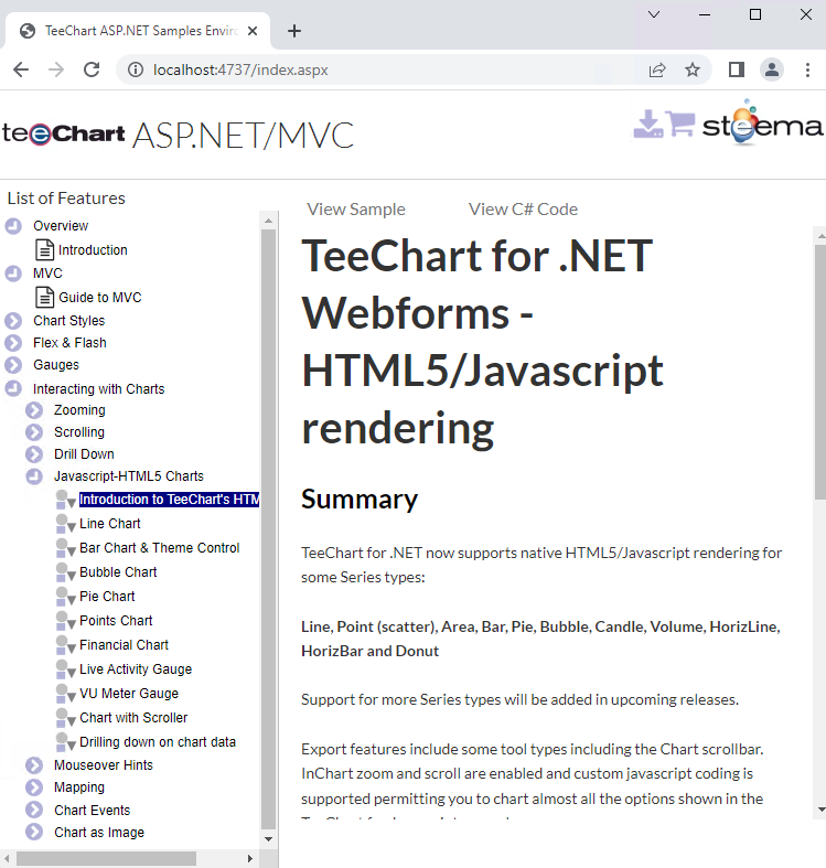

We have a Website project example in one of our GiHub repos for .NET Framework 4, which you can see here:
https://github.com/Steema/TeeChart-NET- ... %20WebDemo
Are any of the techniques shown there helpful to you? We would especially recommend working with our Javascript-HTML5 chart:
Screenshot from 2022-08-10 12-01-36.png (122.92 KiB) Viewed 15962 times
Please let us know, with code examples if possible, what exactly you would like to achieve.
