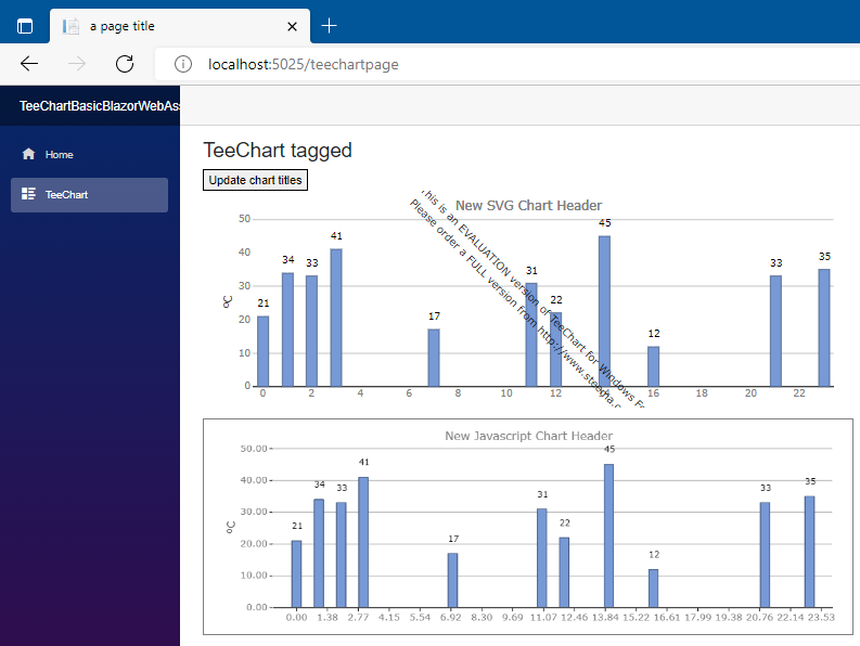

Without license file, the SVG chart shows the evaluation watermark, while the JS version does not show such a watermark.
After adding my TeeChart.licenses file to the project as embedded resource, this behaviour does not change, see attached screenshot.
So, can you please
1) confirm that no license is necessary to use the JS version of the chart component, and
2) tell me how to remove the watermark for the SVG version?
Ansgar
2022-08-23 16_13_40-Window.png (42.73 KiB) Viewed 5471 times

thanks for the new license file which I could successfully activate.
Unfortunately, the watermark is still present with the new TeeChart.licenses file.
