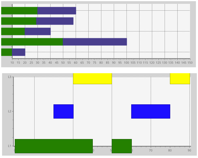

I checked the setting you recommended (mChart.Aspect.ClipPoints = false) and it actually fixed the line and the stairs area series. Unfortunately, it is not a universal solution because it causes other types of series that I use to be painted incorrectly, e.g. HorizBar and Gantt, causing them to display outside the Chart axes.
