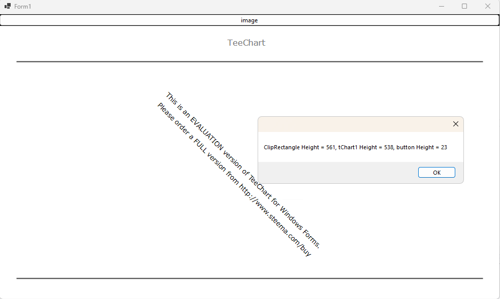

If I use this code:
    private TChart tChart1;
      tChart1 = new TChart();
      this.Controls.Add(tChart1);
      Button btnOK = new Button();
      btnOK.Text = "image";
      btnOK.Dock = DockStyle.Top;
      this.Controls.Add((Button)btnOK);
      btnOK.Click += (s, e) =>
        tChart1.Export.Image.Bitmap.CopyToClipboard();
      this.Paint += (s, e) =>
        MessageBox.Show($"ClipRectangle Height = {e.ClipRectangle.Height}, tChart1 Height = {tChart1.Height}, button Height = {btnOK.Height}");
I obtain this:
Screenshot from 2023-01-26 15-49-30.png (21.5 KiB) Viewed 9472 times

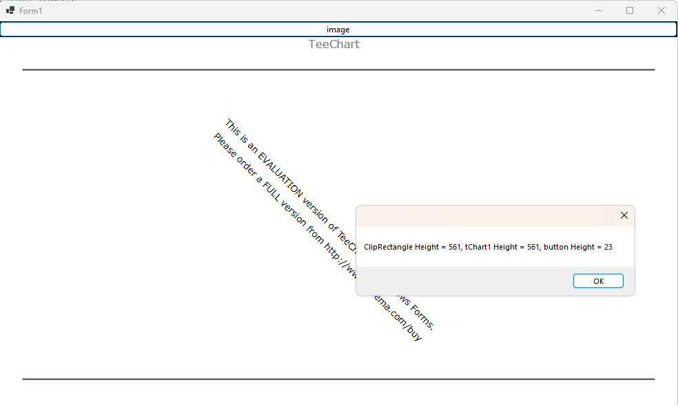

Whereas with this code:
I obtain this:
Screenshot from 2023-01-26 15-53-28.png (20.16 KiB) Viewed 9472 times

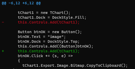

This helps us to understand what is happening. When we add the Button to the Form's Controls collection _after_ we add the Chart, the Chart's Height area is reduced by the Height of the Button. When we add the Button to the Form's Controls collection _before_ we add the Chart, the Chart maintains the same Height as the Height of the Form's ClipRectangle. When the Chart's Height is reduced, we obtain the black rectangle, and when the Chart's Height isn't reduced we do not.
Our best suggestion is that you design your Windows Forms so that the addition of Controls to the Form's Controls collection does not reduce Height of the Chart. In the case of the code snippet that produces a black rectangle, the first snippet, removing the black rectangle involves moving a single line of code:
diff --git a/ctl1.txt b/ctl2.txt
index 431ee06..13e3488 100644
--- a/ctl1.txt
+++ b/ctl2.txt
@@ -6,12 +6,12 @@
-      this.Controls.Add(tChart1);
+      this.Controls.Add(tChart1);

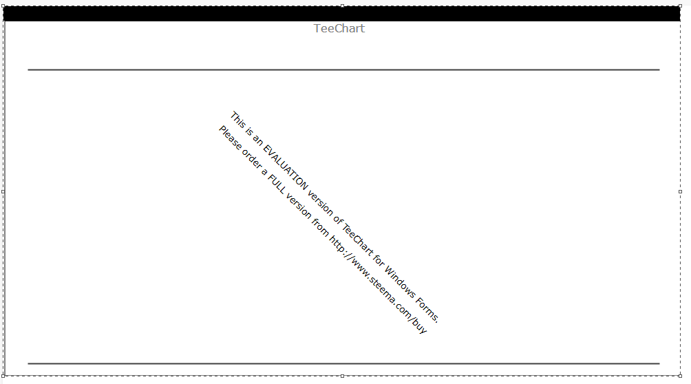

Just to be clear. This code:
gives me this image when I click the button:
Screenshot from 2023-01-27 09-42-46.png (17.5 KiB) Viewed 9434 times

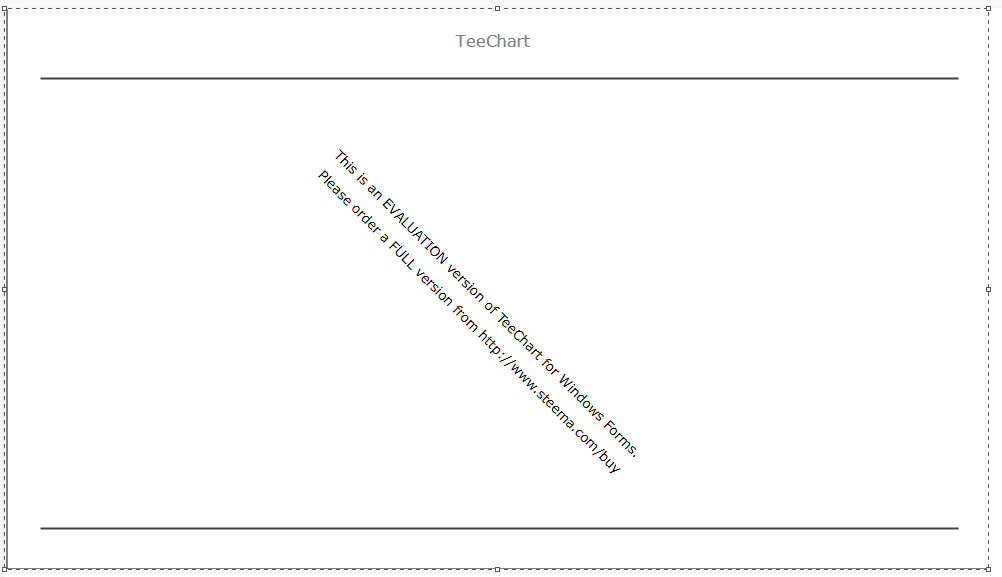

Whereas this code:
gives me this image:
Screenshot from 2023-01-27 09-43-52.png (17.63 KiB) Viewed 9434 times
The difference between the code that gives me the bad image and the code that gives me the good image is a single line:
Screenshot from 2023-01-27 09-45-38.png (23.93 KiB) Viewed 9434 times
The reason for why this is happening I explain in my first reply. I trust that this makes the issue clear to you.
