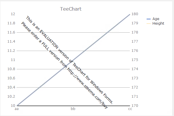

Maybe you can make something of code like this:
        class Request
            public string? Name { get; set; }
            public int Value { get; set; }
            public static Request Empty { get; set; } = new Request { Name = null, Value = -1 };
            List<Request> GetData(string request)
                var response = "[{\"name\":\"aa\",\"age\":10,\"height\":170},{\"name\":\"bb\",\"age\":11,\"height\":175},{\"name\":\"cc\",\"age\":12,\"height\":180}]";
                var data = JsonSerializer.Deserialize<JsonElement>(response).EnumerateArray();
                var req = JsonSerializer.Deserialize<JsonElement>(request).EnumerateArray();
                var data_nv = data.SelectMany(x => x.EnumerateObject()).Where(x => x.Name == req.First().GetString() || x.Name == req.Last().GetString()).Select(x => x.Value);
                return Enumerable.Zip(data_nv, data_nv.Skip(1), (x, y) =>
                    if (x.ValueKind == JsonValueKind.String)
                        return new Request { Name = x.GetString(), Value = y.GetInt32() };
                        return Request.Empty;
                }).Where(x => x != Request.Empty).ToList();
            var age = new Line(tChart1.Chart);
            age.YValues.DataMember = "Value";
            age.LabelMember = "Name";
            age.Title = "Age";
            age.LinePen.Width = 3;
            age.Add(GetData("[\"name\",\"age\"]") as IList);
            var height = new Line(tChart1.Chart);
            height.YValues.DataMember = "Value";
            height.LabelMember = "Name";
            height.Title = "Height";
            height.Add(GetData("[\"name\",\"height\"]") as IList);
            height.VertAxis = VerticalAxis.Right;

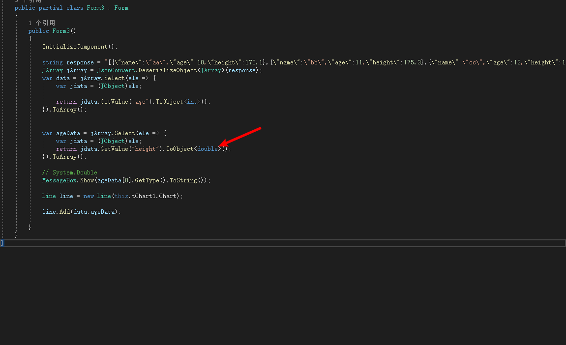

Hello:
Maybe you misunderstood.
the code like:
            string response = "[{\"name\":\"aa\",\"age\":10,\"height\":170.1},{\"name\":\"bb\",\"age\":11,\"height\":175.3},{\"name\":\"cc\",\"age\":12,\"height\":173.5}]";
            JArray jArray = JsonConvert.DeserializeObject<JArray>(response);
            var data = jArray.Select(ele => {
                var jdata = (JObject)ele;
                return jdata.GetValue("age").ToObject<int>();
            }).ToArray();
            var ageData = jArray.Select(ele => {
                return jdata.GetValue("height").ToObject<object>();
            }).ToArray();
            // System.Double
            MessageBox.Show(ageData[0].GetType().ToString());
            Line line = new Line(this.tChart1.Chart);
            line.Add(data,ageData);
when i change the object to double, it's ok. But maybe it's int.
so i want to use object , and i actually get index 0 data type is System.Double , why TeeChart can't use it.
Re: dynamic property class for mutilple series
Post by Christopher » Wed Feb 15, 2023 12:31 pm
I can see again that I did understand your problem. Your problem is with Newtonsoft Json.NET. All the examples I used were using Microsoft's System.Text.Json namespace, which again is not strictly a TeeChart issue.
Again I will say that it will be perfectly possible to check for the type and convert it correctly using System.Text.Json, as I mentioned in my last message. If you need help in using either Json.NET or System.Text.Json within your TeeChart app, can I again please suggest you consider the use of our consulting services.
