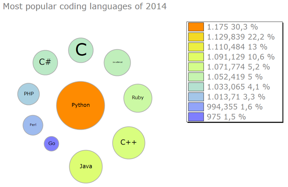

Can I know how to plot the Bubble Cloud Chart in SteemaGallery using TeeChart .NET and C#? Can I have the codes for this chart?
You may find the chart in these links https://www.steema.com/linkIn/chart_gallery and
https://www.steema.com/uploads/products/ProgLangs.png.
Attached the chart.
Steema Gallery - Bubble Cloud.png (125.15 KiB) Viewed 7478 times

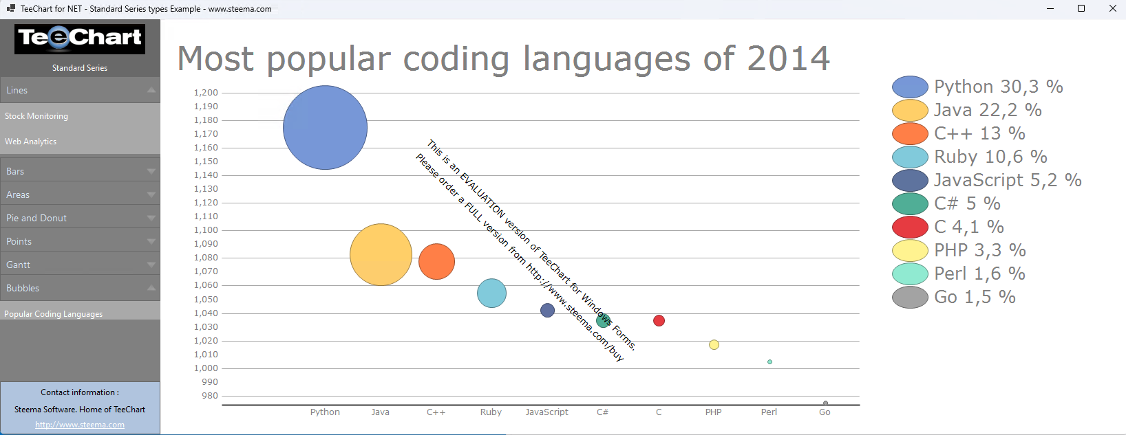

although not exactly that image, there's a bubble cloud example in our GitHub examples here. Running that example and navigating the menu on the left gives me:
Screenshot from 2023-04-06 12-15-26.png (118.75 KiB) Viewed 7472 times
Although this example is for the Business version of TeeChart, it will also work for the Pro version.

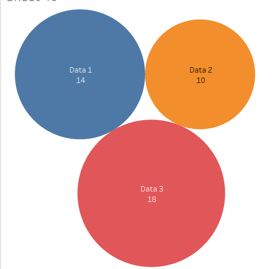

I am actually looking for chart which plots based on the points size, without axes hence the random position for points. Can I have the sample code of a chart where it only plots the points (bubbles) according to the size?
For example, the data is
and the chart will be
The position of the points (bubbles) are random and placed automatically without overlapping each other. No x axis and y axis values. The Data/Label column will be used to label and distinguish the bubbles whereas the size of the bubbles are determined by the size column.

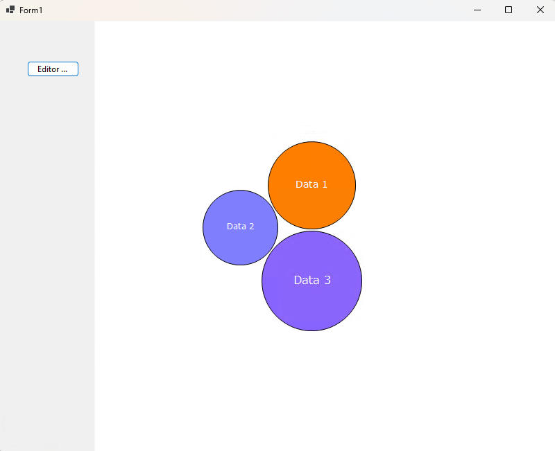

Post by Christopher » Tue Apr 11, 2023 8:05 am
I can use the following code:
            InitializeChart();
            tChart1.Header.Visible = false;
            var bcloud = new BubbleCloud(tChart1.Chart)
                UseColorRange = false,
                UsePalette = true,
                PaletteStyle = PaletteStyles.Strong
            bcloud.Add(14, "Data 1");
            bcloud.Add(10, "Data 2");
            bcloud.Add(18, "Data 3");
            bcloud.Separation = 3;
            bcloud.SizeRatio = 4;
            bcloud.Rotation = 180;
To produce this Chart:
Screenshot from 2023-04-11 12-09-29.png (34.47 KiB) Viewed 7421 times
Is this what you are looking for?
