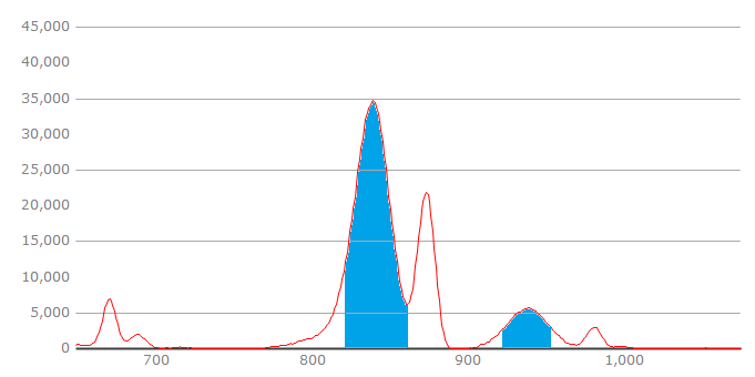

I want to draw a area + line type graph like the attached picture file.
I tried to draw line + area series, but i couldn't. Only line-type graphs were drawn on the chart.
I'd be grateful if you could tell me how.

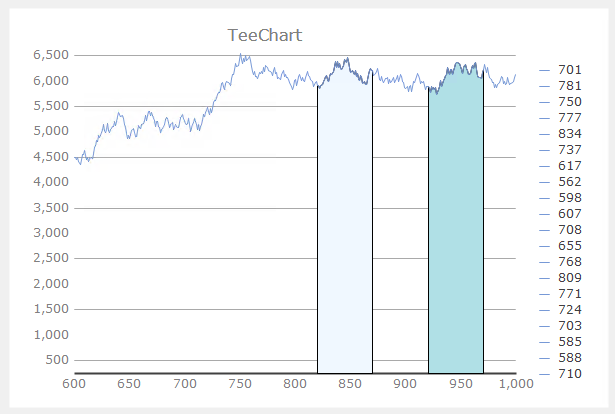

for drawing the area under a curve, you can use the SeriesRegion tool like this:
            var line = new Line(tChart1.Chart);
            line.FillSampleValues(1000);
            tChart1.Axes.Bottom.SetMinMax(600, 1000);
            _ = new SeriesRegionTool(tChart1.Chart)
                AutoBound = false,
                LowerBound = 820,
                UpperBound = 870,
                Series = line,
                DrawBehindSeries = true,
                Color = System.Drawing.Color.AliceBlue,
                AutoBound = false,
                LowerBound = 920,
                UpperBound = 970,
                Series = line,
                Color = System.Drawing.Color.PowderBlue,
