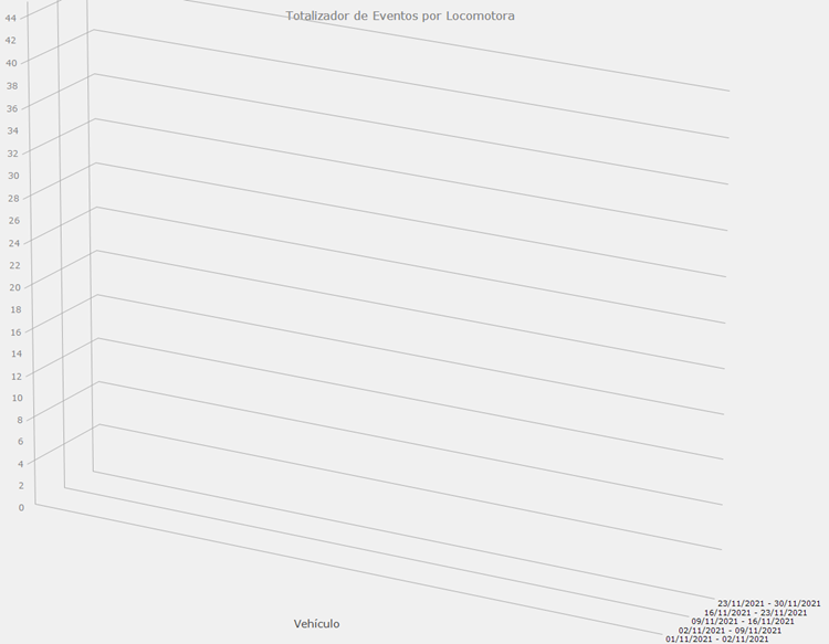

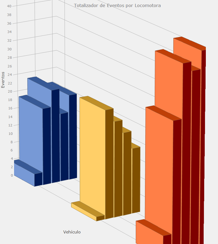

I have recently upgraded my project from the 2016 library to the latest 2023 one. The problem is that i am experiencing an issue with the 3D graphic bars. When i amply a slight rotation to the graphic, the bars disappear. This issue was not present with the 2016 version. I have attached two images with my initial state and when i apply some rotation.
Initial state:
After rotation:
Thank you.

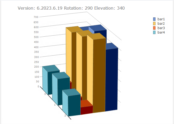

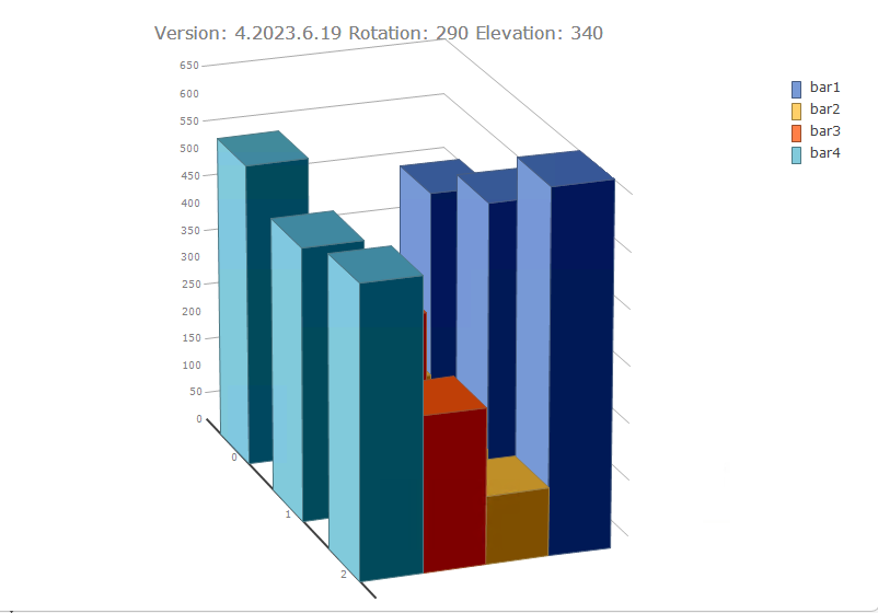

Re: 3D issues with TeeChart for .NET v2023
Post by Christopher » Thu Jun 22, 2023 9:21 am
Using this code:
            void TChart1_AfterDraw(object sender, Steema.TeeChart.Drawing.IGraphics3D g)
                tChart1.Header.Text = $"Version: {Utils.Version} Rotation: {tChart1.Aspect.Rotation} Elevation: {tChart1.Aspect.Elevation}";
            for (int i = 0; i < 4; i++)
                var bar = new Bar(tChart1.Chart);
                bar.FillSampleValues(3);
                bar.MultiBar = MultiBars.None;
                bar.Marks.Visible = false;
            tChart1.Walls.Visible = false;
            tChart1.Aspect.View3D = true;
            tChart1.Aspect.Orthogonal = false;
            tChart1.Aspect.Chart3DPercent = 50;
            tChart1.Aspect.Zoom = 75;
            tChart1.Aspect.Rotation = 290;
            tChart1.Aspect.Elevation = 340;
            tChart1.Tools.Add(typeof(Rotate));
            tChart1.Draw();
Against NuGet v.4.2023.06.19, I obtain this for the .NET Framework 4.0 assembly:
Screenshot from 2023-06-22 11-09-34.png (36.73 KiB) Viewed 12441 times
And this for the .NET 6.0 assemblies:
Screenshot from 2023-06-22 11-15-32.png (98.48 KiB) Viewed 12441 times
When I move the Chart around using the Rotate tool I am unable to find a position in which bars disappear. Could you please modify this code so I can reproduce your issue in one (or both) of the .NET runtimes?
