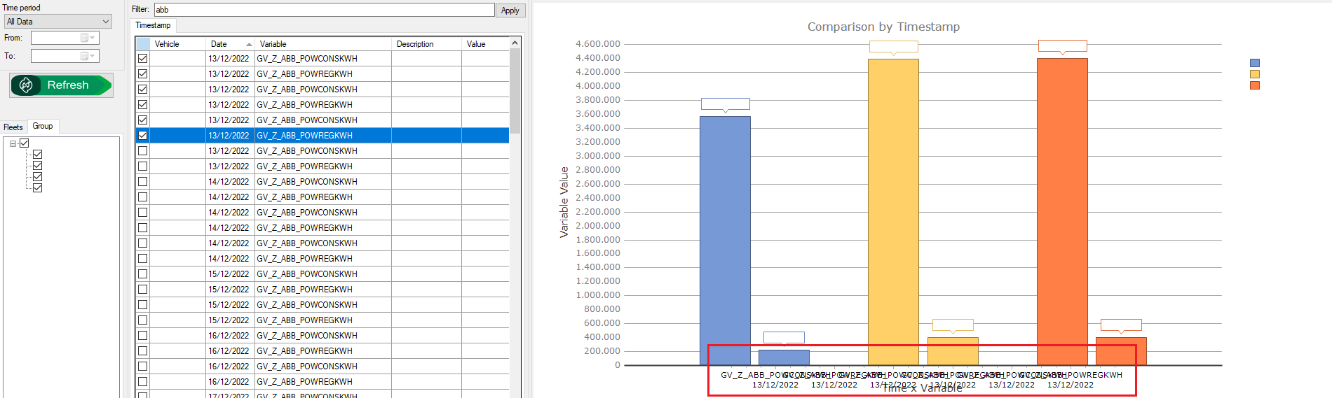

I have an issue where the axis variables collide because of the quantity of text they have, is there any property or solution to force the chart to respect this ones between them inserting some space or separation?
Our usual recommendation in these circumstances is to change the axis labels' angle, e.g.
