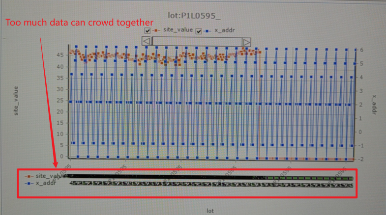

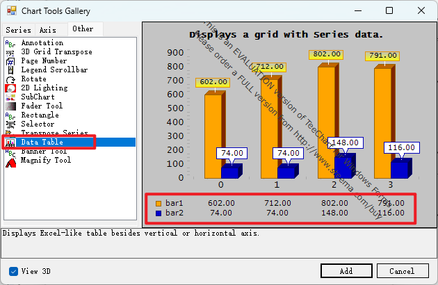

Use the table in the TChart Tools, but the table has no grid lines and too much data will be crowded together, can I add a scroll bar up and down left and right?
1) TChart Tool : DataTable
2) I want the table to have grid lines
need grid lines.png (124.09 KiB) Viewed 17472 times
3) Data crowding together want to scroll bar
want to scroll bar.png (488.2 KiB) Viewed 17472 times
Re: How to adjust table styles adaptively?
Post by Marc » Mon Aug 21, 2023 4:34 pm
Re.
Open the Chart Editor after adding the tool go to the tool in the toolslist and select:
- Rows to edit the horizontal Pen
- Columns to edit the vertical Pen (display the grid lines)
Re.
The table can only practically fit a certain amount of readable data (text). If there are two many points the it is not possible to space the text. If you tell us what you would like to see here perhaps we can think of a suggestion.
