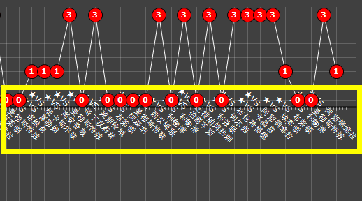

The above figure shows the position of the labels when Axis4. Labels. Angle=315

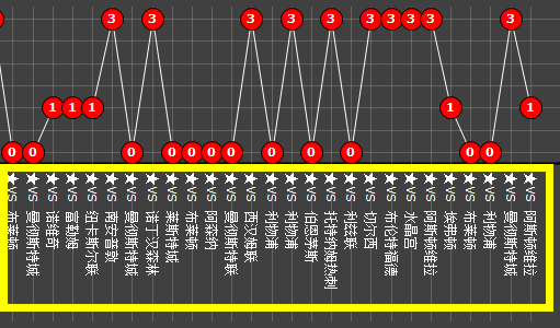

The following figure shows the position of the labels when Axis4. Labels. Angle=270
How to adjust the position of labels when Axis4. Labels. Angle=315 downwards and rightward

Apologies for the delay replying. Currently, non-regular angles, (not 0,90,180,270), are not correctly rendering distance from the axis. We are reviewing the code related to this area.
Re: Position setting of coordinate axis labels
Post by Marc » Tue Nov 21, 2023 6:15 pm
The issue has been resolved (issues #2651]) and the solution will be included with the next TeeChart update.
I have ported this code back into the relevant method for the sourcecode version, 4.1.2017.02140, and although I am unable to test all possible usage scenarios for this version, it should work for you if you replace this entire method in the Axis.cs unit.:

      if ((horizontal) && ((this.chart.Tools.Count > 0) && (hasScrollTool())))
        g.ClipRectangle(CalcXPosValue(minimumValue), 0,
                        CalcXPosValue(maximumValue), Chart.Height);
#endif
      DoGetAxisDrawLabel(this, ref x, ref y, ref tmpZ, ref tmpSt, ref tmpDraw);
      if (tmpDraw) n = NumTextLines(tmpSt);
      if (tmpDraw)
        for (int tt = 1; tt <= n; tt++)
          double tmpAngle = format.Width / 2;
          if (OtherSide)
            tmpAngle = tmpAngle - 0.25 * format.Height;
          double tmpYDisp = tmpAngle * Math.Abs(Math.Sin(Utils.Deg2Rad(angle)));
          if (angle > 0)
            format.Bottom = tmpFT;
            format.Top = tmpFT + (int)tmpYDisp; // - tmpFH;
            if ((angle >= 0) && (angle <= 90))
#if iOS
              if (!isTitle)
#endif
              if (angle == 90)
                x += delta - (tmpFontHeight / 4);
                x += delta - (int)(tmpFontHeight / 4 * Math.Abs(Math.Sin(Utils.Deg2Rad(angle))));
              format.Left += delta;
              format.Right += delta;
            else if ((angle > 90) && (angle <= 180))
              if (angle == 180)
                x -= format.Width / 2;
                x -= (int)(tmpFontHeight / 2 * Math.Abs(Math.Sin(Utils.Deg2Rad(angle))));
              y += (int)(tmpFontHeight * Math.Abs(Math.Cos(Utils.Deg2Rad(angle))));
            else if ((angle > 180) && (angle <= 270))
              x -= delta;
              format.Left -= delta;
              format.Right -= delta;
            else if ((angle > 270) && (angle < 360))
              x += (int)(format.Width / 2 * Math.Abs(Math.Cos(Utils.Deg2Rad(angle))));
              y += (int)(format.Width / 2 * Math.Abs(Math.Sin(Utils.Deg2Rad(angle))));
              format.Top += delta;
              format.Bottom += delta;
          if (!format.Transparent || hasClicked)
#if SILVERLIGHT || WPF || STORE
            if (angle > 0)
              RotateTransform rotate = new RotateTransform();
              rotate.Angle = 360 - angle;
              rotate.CenterX = x;
              rotate.CenterY = y;
              double tmpFW = format.Width;
              format.Left += tmpFW / 2.0;
              format.Right += tmpFW / 2.0;
#if STORE
              format.ShapePolygonBounds = new Point[] { rotate.TransformPoint(new Point(format.ShapeBounds.Left, format.ShapeBounds.Top)),
              rotate.TransformPoint(new Point(format.ShapeBounds.Right, format.ShapeBounds.Top)),
              rotate.TransformPoint(new Point(format.ShapeBounds.Right, format.ShapeBounds.Bottom)),
              rotate.TransformPoint(new Point(format.ShapeBounds.Left, format.ShapeBounds.Bottom)),
              rotate.TransformPoint(new Point(format.ShapeBounds.Left, format.ShapeBounds.Top))};
#else
              format.ShapePolygonBounds = new Point[] { rotate.Transform(new Point(format.ShapeBounds.Left, format.ShapeBounds.Top)),
              rotate.Transform(new Point(format.ShapeBounds.Right, format.ShapeBounds.Top)),
              rotate.Transform(new Point(format.ShapeBounds.Right, format.ShapeBounds.Bottom)),
              rotate.Transform(new Point(format.ShapeBounds.Left, format.ShapeBounds.Bottom)),
              rotate.Transform(new Point(format.ShapeBounds.Left, format.ShapeBounds.Top))};
#endif
              g.Brush = format.Brush;
              g.Pen = format.Pen;
              g.Polygon(format.ShapePolygonBounds);
              format.DrawRectRotated(g, format.ShapeBounds, 0, tmpZ);
#elif !POCKET
            Matrix m = g.GDIplusCanvas.Transform;
            m.RotateAt((float)(360 - angle), new Point(x, y));
            g.GDIplusCanvas.MultiplyTransform(m);
            format.ShapePolygonBounds = new Point[] { new Point(format.ShapeBounds.Left, format.ShapeBounds.Top), new Point(format.ShapeBounds.Right, format.ShapeBounds.Top),
                new Point(format.ShapeBounds.Right, format.ShapeBounds.Bottom), new Point(format.ShapeBounds.Left, format.ShapeBounds.Bottom), new Point(format.ShapeBounds.Left, format.ShapeBounds.Top)};
            m.TransformPoints(format.ShapePolygonBounds);
            g.GDIplusCanvas.ResetTransform();
#endif
            labels.labelPos.Add(format.ShapePolygonBounds);
            labels.labelPos.Add(format.ShapeBounds);
          i = tmpSt.IndexOf(Texts.LineSeparator);
          tmpSt2 = (i != -1) ? tmpSt.Substring(0, i) : tmpSt;
          if (angle == 0)
            y += delta;
            g.Font = f;
            if (labels.Exponent)
              DrawExponentLabel(x, y, tmpZ, tmpSt2, angle);
            else if (is3D)
              g.TextOut(x, y, tmpZ, tmpSt2, format.TextFormat == TextFormat.Html);
              g.TextOut(f, x, y, tmpSt2, format.TextFormat == TextFormat.Html);
            if (labels.Exponent && (angle == 90 || angle == 270))
              g.RotateLabel(x, y, tmpZ, tmpSt2, angle, format.TextFormat == TextFormat.Html);
          if (i >= 0) tmpSt = tmpSt.Remove(0, i + 1);
      g.TextAlign = OldStrAlign;
Alternatively, you can upgrade to the latest version of TeeChart to access the modification directly.
