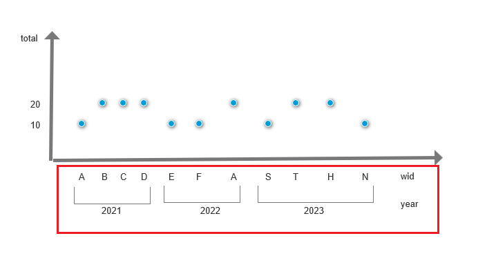

I hope to use the dataset with:
	{year: 2021, wid: 'A',total: 10},
	{year: 2021, wid: 'B',total: 20},
	{year: 2021, wid: 'C',total: 20},
	{year: 2021, wid: 'D',total: 20},
	{year: 2022, wid: 'E',total: 10},
	{year: 2022, wid: 'F',total: 10},
	{year: 2022, wid: 'A',total: 20},
	{year: 2023, wid: 'S',total: 10},
	{year: 2023, wid: 'T',total: 20},
	{year: 2023, wid: 'H',total: 20},
	{year: 2023, wid: 'N',total: 10}
then the chart will show like:
the element 1-4 with the same year 2021,then i want to show once below the wid,
the element 5-8 with the same year 2022, then the year ‘2022 ’ show below the three wid value
when i has the same value,then show with sub axes below the origin x label
how need i to to?

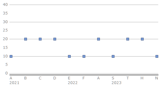

Perhaps I'm not understanding the question well so I'll answer different aspects in the way I see them.
An index on the data would give you the exact chart you want without the year labels:
ie.
int[] idx = { 0, 1, 2, 3, 4, 5, 6, 7, 8, 9, 10 };
int[] year = { 2021, 2021, 2021, 2021, 2022, 2022, 2022, 2023, 2023, 2023, 2023 };
string[] label = { "A", "B", "C", "D", "E", "F", "A", "S", "T", "H", "N" };
double[] total = { 10, 20, 20, 20, 10, 10, 20, 10, 20, 20, 10 };
private void Form1_Load(object sender, EventArgs e)
    //note an index (idx here) is not required for this add overload as it is automatically added, but it
    //helps to include it for clarity/understanding.
    for (int i = 0; i < 11; i++)
        points1.Add(total[i], label[i]);
        //or
        //points1.Add(idx[i], total[i], label[i]);
    tChart1.Axes.Left.SetMinMax(0, 50);
You can add the year to the label in this way, via the OnGetAxisLabel event:
private void tChart1_GetAxisLabel(object sender, Steema.TeeChart.GetAxisLabelEventArgs e)
    if (sender == tChart1.Axes.Bottom)
        if (e.ValueIndex != -1)
            e.LabelText = e.LabelText + "\n" + year[e.ValueIndex].ToString();
If you only want the year once, at the first value of the year for example, then you could setup the OnGetAxisLabel event in this way:
int lastYear = -1;
            if (lastYear != year[e.ValueIndex])
                e.LabelText = e.LabelText + "\n      " + year[e.ValueIndex].ToString();
                lastYear = year[e.ValueIndex];
There are other options, including putting the year to the centre of each range, but that requires a little more work…

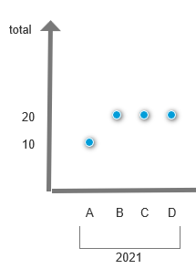

Thank you for help. It's close to what I want.

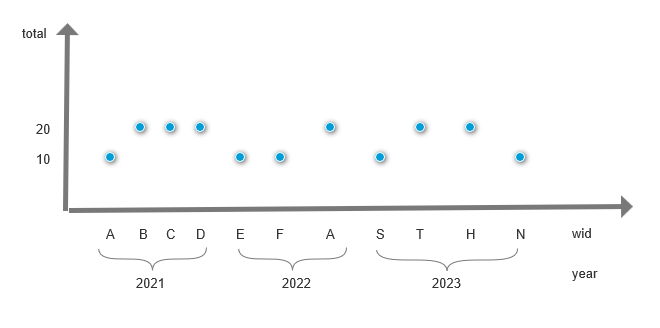

I want to custom the same year symbol, like the
or
Then I have try to use custom Drawing url,but failed.
how to draw the specified symbol above the year value
Could you help me please!
I hope the X look like
Through this result, I can directly see that A, B, C and D have the same year 2021.
Re: how to show the merged X axes?
Post by Marc » Thu Nov 09, 2023 8:15 am
Use the moveTo, lineTo Canvas methods to plot the lines you require.
Ypu can get the coordinates for each location by converting the axis location you wish for the group you decide.
ie.
/*x location:*/ tChart1.Axes.Bottom.CalcXPosValue(yourPointvalue)
/*y location:*/ tChart1.Axes.Left.CalcYPosValue(tChart1.Axes.Left.Minimum)
                     //gets bottom Axis location to which you can add the distance you require
/*or....*/
tChart1.Axes.Bottom.Position
Use the OnAfterDraw event for the custom drawing code.
Example of moveTo, LineTo from the tutorial I linked (this plots a diagonal line across the Chart:
private void tChart1_AfterDraw(object sender, Steema.TeeChart.Drawing.Graphics3D g) {
        Point s = new Point(tChart1.Axes.Left.Position, tChart1.Axes.Top.Position);
        Point e = new Point(tChart1.Axes.Right.Position, tChart1.Axes.Bottom.Position);
        g.MoveTo(s);
        g.LineTo(e,0);
You can add the Year text in this way too, using the Canvas textOut method.
Example from tutorial:
        string text = "My Text";
        Size s = new Size(150, 50);
        Point p = new Point(g.ChartXCenter - (s.Width/2), g.ChartYCenter - (s.Height/2));
        Rectangle r = new Rectangle(p,s);
        g.Pen.Color = Color.Blue;
        g.Rectangle(r);
        g.TextOut(Convert.ToInt32(g.ChartXCenter - (g.TextWidth(text)/2)), Convert.ToInt32(g.ChartYCenter - (g.TextHeight(text)/2)), text);
If you can't access the custom drawing tutorial page I linked (I assume you can as you can access this forum page) there is an offline version here you can download:
https://www.steema.com/files/public/tee ... neDocs.zip
There's some work to write a calculation of the x and y locations of the points for each range, I'm not going to do that here as it requires more time than I have available right now; it's a question of deciding a system to group/set the point ranges and returning min-max points for the range for which to plot the lines. Once the rule is decided it can be applied generically for all cases.

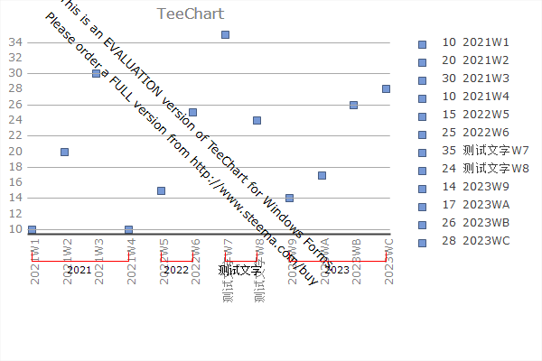

When i use the margin, i faced the new problem.
The normal image is :
if the x label is long ,then i set the angle to 90 caues the result
i use the code:
tChart1.Axes.Bottom.Position + symbolBase to calc the custom symbol y position.
The x label is dynamical.
So i want to know how to get the standard calc function to get the point Y value then they can't overlap each other
Post by Marc » Tue Nov 14, 2023 11:56 am
Here's an example how to dynamically modify the location of output relative to Axis Label angle. This example outputs a small test text sample.
  //declare var for max label width (length)
  double maxLabelWidth = 0;
  //then in Form_load or data refresh set:
  maxLabelWidth = tChart1.Axes.Bottom.MaxLabelsWidth();
  //will use radians for angle calcs
  public double ConvertToRadians(double angle)
    return (Math.PI / 180) * angle;
  //this example outputs test text in OnAfterDraw
    double hyp = maxLabelWidth;
    //some simple trig:
    //sin(@) = opp/hyp
    //yDisp = opp  therefore  = hyp * sin(@)
    double angleRad = ConvertToRadians(tChart1.Axes.Bottom.Labels.Angle);
    double yDisp = tChart1.Axes.Bottom.Labels.Height; //minimum
    if ((tChart1.Axes.Bottom.Labels.Angle >= 0) && (tChart1.Axes.Bottom.Labels.Angle < 180))
      yDisp = yDisp + Math.Sin(angleRad) * maxLabelWidth;
      yDisp = yDisp + Math.Sin(angleRad) * maxLabelWidth * -1;
    g.TextOut(10, (int)(tChart1.Axes.Bottom.Position + yDisp), "test label");
