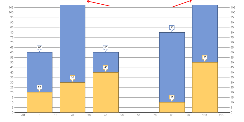

First problem: When the bar value exceeds the upper range of the chart axis, an unnecessary line is drawn at the top of the chart.
Second problem: When we add two series of bars, so that one is connected to the left axis and the other to the right axis, they unexpectedly stack up.

Thank you for the bug report. Point 1 is reproducible. It may be an error with the clipping region at render time; we'll take a look. bug ref bug id 2663.
Point 2 can be corrected by alllocating the right axis in this way:
bar2.VertAxis = VerticalAxis.Right;
If you wish to use a Custom Vertical Axis you must first define it. More info here:
Axes tutorial.

I will use VertAxis instead of CustomVertAxis.
I was porting the code from the .Net WinForms version in which the bar2.CustomVertAxis = mChart.Axes.Right; worked correctly even though bar2.VertAxis = VerticalAxis.Right; should probably have been used there as well.
