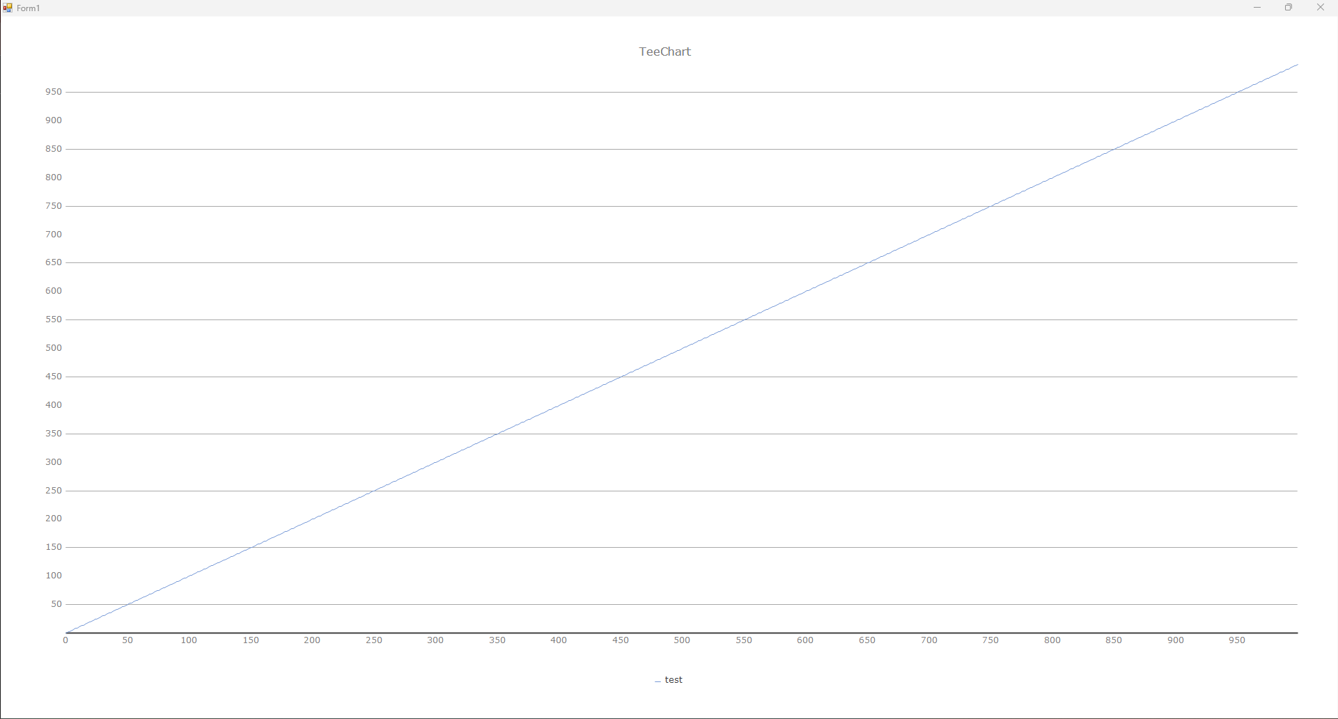

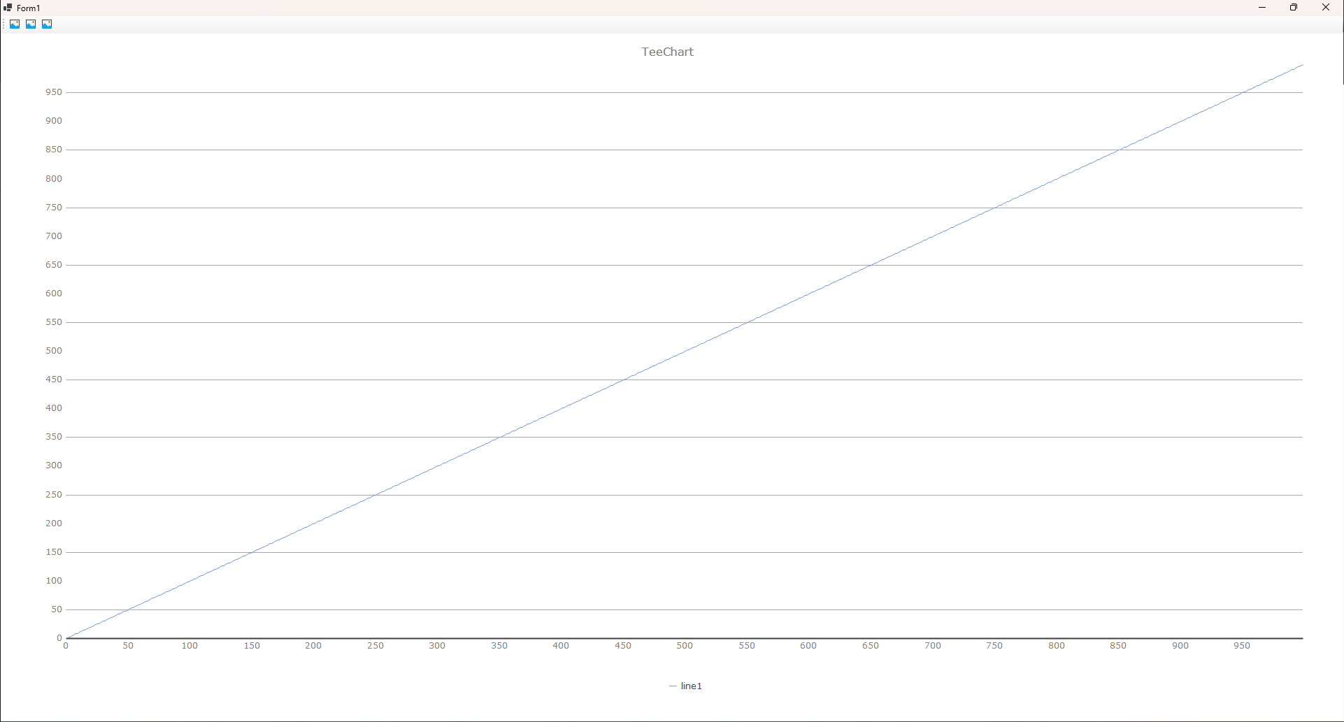

After loading a template file the series title does not get saved off correctly. This seems to work in ,netFramework but not in .net 6.0. In the two screenshots below the one in .net framework puts the Title to "test" whereas the on in .net 6.0 puts title to "line1"
Steema.TeeChart.TChart tChart1;
this.Controls.Add(tChart1);
tChart1.Axes.Bottom.Visible = true;
tChart1.Axes.Left.Visible = true;
tChart1.Axes.Right.Visible = false;
tChart1.Legend.Visible = true;
tChart1.Legend.LegendStyle = LegendStyles.Series;
LoadData();
TemplateExport template = tChart1.Export.Template;
template.IncludeData = true;
tChart1.Export.Template.Save("template.json");
tChart1.Import.Template.Load("template.json");
private void LoadData()
tChart1.Legend.Alignment = Steema.TeeChart.LegendAlignments.Bottom;
Series line = new Line();
line.Title = "test";
line.Marks.FollowSeriesColor = true;
tChart1.Chart.Series.Add(line);
for (int i = 0; i < 1000; i++)
line.Add(i, i);

the problem has been resolved and the fix will be included with the next Nuget release.
