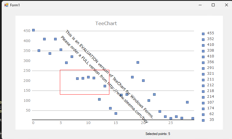

And this is how it looks like:

Made a showcase for you: In this example, I want to have a button that erases the rectangle after I click it
        bool shouldRectangleBeDeleted = false;
        private void button_Click(object sender, RoutedEventArgs e)
            shouldRectangleBeDeleted = true;
            tChart1.Invalidate();
        private void TChart1_AfterDraw(object sender, IGraphics3D g)
            int startX = (int)Math.Min(down.X, up.X);
            int endX = (int)Math.Max(down.X, up.X);
            int startY = (int)Math.Min(down.Y, up.Y);
            int endY = (int)Math.Max(down.Y, up.Y);
            g.Brush.Transparency = 100;
            g.Pen.Color = System.Drawing.Color.Blue;
            if (shouldRectangleBeDeleted)
                g.Rectangle(0, 0, 0, 0); // inviisble rectangle
                shouldRectangleBeDeleted = false; // reset boolean check after erasing
                g.Rectangle(startX, startY, endX, endY);
Please note that this is a basic example to demonstrate how you can control the flow of your program. You have the flexibility to trigger actions using various methods, such as key presses, different conditions, or other input mechanisms beyond a simple boolean check. The specific approach you choose will depend on how you want your program to behave and the user experience you envision. Feel free to explore and implement the method that best suits your needs.
I only want to highlight some points in the series included in the square and try to redraw the chart.
Is it possible to refresh only the corresponding points or series from a large amount of data?
You can, for example, create another Series and populate them as you "find data points inside the rectangle". Then, make the first series ("myPoints") invisible, for example. Here are some lines of code to guide you:
1.- Setting up series
        Points myPoints;
        Points myHighlightedPoints;
         myPoints = new Points(tChart1.Chart);
         myHighlightedPoints = new Points(tChart1.Chart);
2.- Inside the loop in the afterdraw function, add the values to our new highlighted series
           if (minX <= xValue    && maxX >= xValue   && minY <= yValue   && maxY >= yValue)
                    //The point x and y is inside the rectangle.
                    pointsInsideRectangle.Add(new Point((float)xValue, (float)yValue));
                    myHighlightedPoints.Add(xValue, yValue); // add to highlighted series
3.- inside a button or after drawing a rectangle or wherever you want, make the first series invisible.
                  myPoints.Visible = false;
Keep in mind that if you use this approach, you'll have to empty the highlightedSeries after every other area selection, or else you'd be carrying over values from your previous select.
Also note that if you make the first series invisible, the chart will automatically move its axes to fit the new data points, making your square be "in the wrong place". To solve this issue, you can use properties like the following to lock in place your chart
tChart1.Axes.Bottom.Maximum = 100;  // Example value
tChart1.Axes.Left.Maximum = 100;
tChart1.Axes.Automatic = false;
Other approaches: You could even have a secondary tChart, which would be empty at first and then you could add the points highlighted on the main tChart.
There are many ways to implement these features, and the best approach will ultimately depend on your specific needs and preferences. I wanted to provide you with a few options to consider, but feel free to explore and choose the one that works best for you.
If there's anything else I can assist you with, or if you'd like to explore other approaches, please don't hesitate to let me know!
